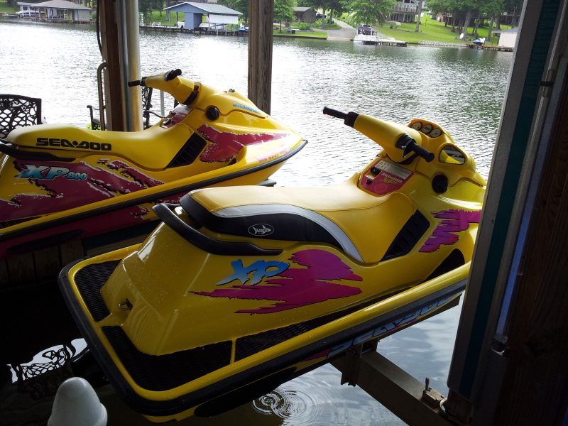

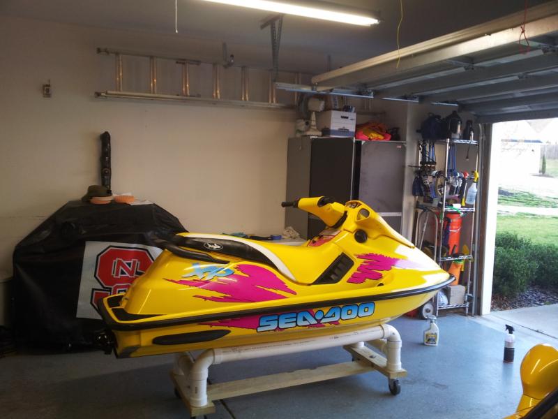

Thanks for reminding me. I did wet sand but only on the PINK portion of the hull. Reds fade worse than any other color and are hard to get back. For the yellow I just used the products I posted.
It's been coming up on 2 years since I did the restore and the color of the gel is just as bright as the day I finished. You will hear people talk about the gel starting to fade or get milky again, well not if you use these products. The 3M heavy duty compound is the best stuff to use period and it will eat right through the dead gelcoat with an Adams green pad. Note that those Adams pads are their 4 inch Focus pads which allows you get get into every nook and cranny of the ski and be much more precise. It is hard work and you just need to take your time and not get into a rush. Just block off small sections at a time and focus on working that area. Some areas you will need to go over twice, maybe even 3 times. The all purpose cleaner was used to clean and prep the gelcoat before using the 3M compound.

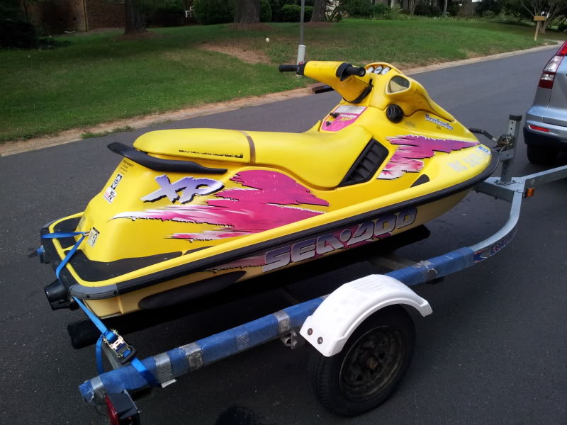

Mine went from this
to this
