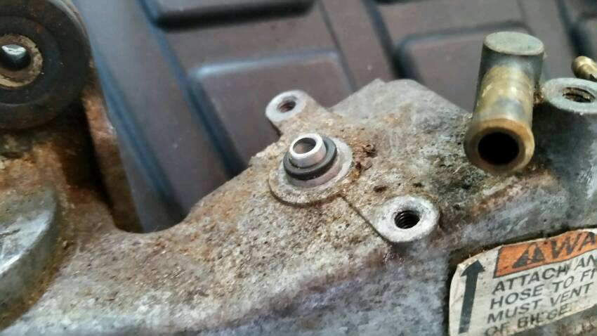

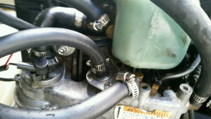

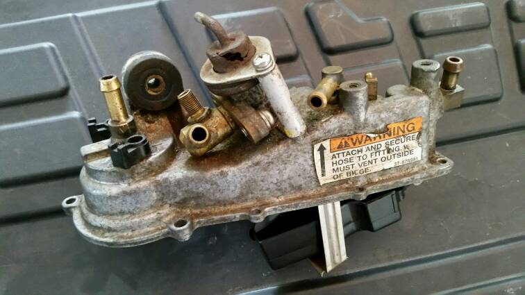

With water was on the garden hose, the vst was really nasty inside. Should I think about pulling and some how cleaning the injectors of any stuck crap from it sitting? I was told the boat sat for a little over a year. The brand new battery put in just before it was not used again was more like 4 years old, definitely sat more than a year, with stabilizer initially.

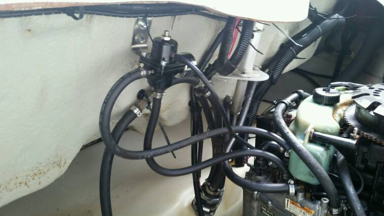

So far I replaced the vst pump, fpr, starter, steering control cable, fuel/water filter and all plugs. When it finally started it would putter and quit as soon as I let off the key, after a few attempts it finally stand running but stalled.
It seems like the more I start it, the longer it stays running.  I assume that's a good sign, as though the garbage is breaking up, it's just really rough and I worry about damaging internals. I know cars pretty well, but never messed with a boat or a 2 stroke.
