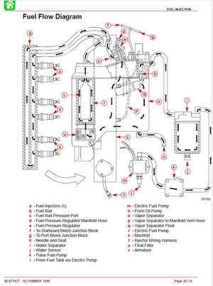

In trying to sort out a possible fuel pressure issues, does anyone have a fuel flow diagram from the tank, to the lift pump, in/out of the pressure pump, etc. etc. etc.... and finally back to the tank?
At first glance it doesn't seem logical the ins and outs of the fuel system. Any help would be appreciated.
