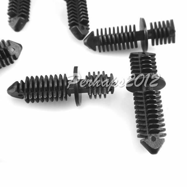

I am now getting round to fitting the seats back into my boat but I can't work out how the front seat backrest is fitted.
I know it is held on with the push in type headlining clips but how the heck do you get it back on? The head of the clip is in the boat and there is no way to get at the back of it to stop it falling in the hull when you push the backrest back on? Normally I would hold the back of the clip but it's just not possible and I have no idea how they did it in the factory.

Do you have any ski locker sized kids? :willy_nilly: That looks impossible, if it were mine I would be coming up with a new clip system, hopefully sombody on here has the answer.
i don't know if they make it but you need sort of a double ended dart where it has barbs on both ends with the "base" in the center..
like this ---|---
^Thats what you need, or push the existing darts into the hull and remove the seat cover and push new darts through the seat first, put cover back on and push darts into hull with the seat.

They look perfect for the job, I will have to find some in the UK though but they must be available.
