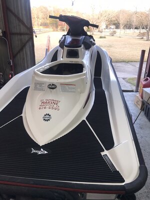

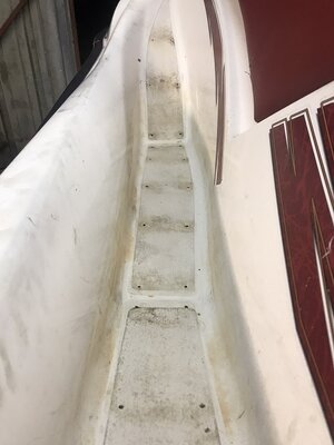

So they look like Bacon? If you replace those you'll have to drill about 70 rivets out the patch all of the holes with a water resistant fiberglass or epoxy. Not a bad job. Just takes some time. With the old mats removed you can get in there and clean and compound the hull. I don't look at any of these skis being classic... I make them as nice as I can.

That looks like a fence to keep horses in. Nice property and good job on the foot pads.👍

Yes sir just like bacon! And you convinced me I think it’s an upgrade rather than the plastic feeling oem. Will post an update when I get enough money to replace the old ones :/ BOAT life amiright
