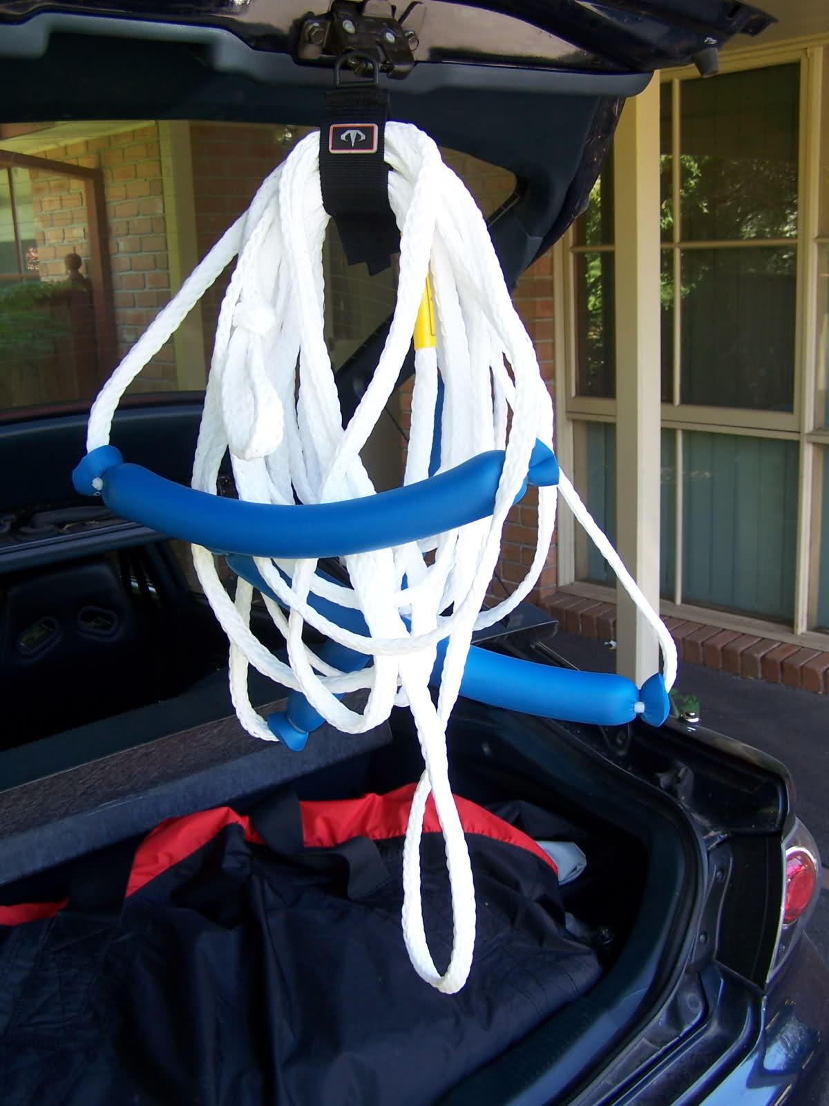

Organised my tubing robe today. Went down the noodle path at Australian store Clark Rubber. Cut it into 4 sections and only used three. Was a little loose on the rope so 2 x cable ties on each section fixed it good. I imagine the small air pocket in there will hopefully help with boyancy too.
Looks like a good job. I heard another Aussie talk about the rubber store, sounds kinky, I asked Cousin Criss about it but he's been pretty close lipped.

Thanks Gris. Thats a seadoo R3 towable I picked up on eBay stuffed in te boot of my buzz box too btw. Will get some photos of it out on the water.Chris is a cool 2000km away from me so I haven't ad te pleasure of meeting yet but will let you knw when I do!
