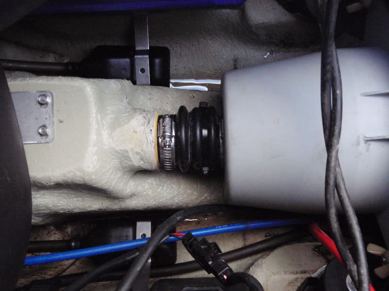

Here's a pic to help, if you haven't played with the carbon seal yet.
Took some quick pics. Any thoughts? It looks a bit different from that picture above.. I tried to slide the ring towards the back of the boat, yet it's going to take a bit of force first.

Looks like yours is on the second groove. AND... there could be a rip in the boot. Personally... I would just pull it apart to get a good look at the parts.
Yea it's on the second one from what I see...plus if you look at your first picture the driveshaft is way out of alignment...you can see it pushing the carbon seal..

are those OEM clamps? they look wider for some reason. That bellows looks compressed a lot as well. I`d start of with all new and align the engine... you need 8mm (5/16) compressed length on the bellows.
read the specs from the shop service manual...

The carbon ring moves side to side (perpendicular to the shaft) about a half inch. I moved it some, which shows in the first pic. That normal?
For now without pulling the shaft I'm going to take out the c clip, unclamp and extend the bellow, take a look at things, etc. Try and get a good look at the face of the carbon seal.
It's already quite tight... not sure if the second groove is stock. I can't imagine it needing more pressure, yet I can slide it to that third groove I suppose.

Make sure the engine isn't moving on the that pic with the seal that is not alligned. The engine might be shifting sucking air.

The engine feels solid, it feels like the actual ring itself can be pushed side to side on the shaft, is that not normal to have some play like that? Is that what would cause the significant cavitation maybe? The side to side action... because it feels quite tight against the stainless ring (though perhaps it's not that tight, if im able to readily push the ring side to side)
Yes... the movement in the seal is normal. It's a floating seal. The ID of the seal is bigger than the driveshaft. But... if it's been running off center (they normally do) and if that the factory seal... it's just time to change it.
