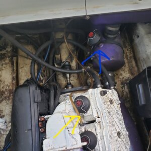

Hey folks, while working on engine (97 Challenger) I pulled this hose off. Not sure where it goes. Thanks for any help.hose.png

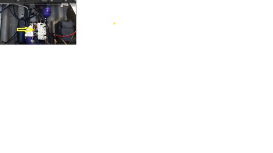

20230818_190658.jpgnot sure where it connects too. The diagram shows connecting to the valve (blue arrow).
If someone has a 97 challenger bombardier and could send a pic of where this tube goes, I would appreciate. Thanks

Thats the bleeder line. It connects to the back so you can see the little stream of water coming out the back to show the cooling system is working.
I tried to find a picture but couldn't. On the outside of the boat right below the tow hook you will see the little outlet. Should be easy to find the connection inside the engine compartment.
