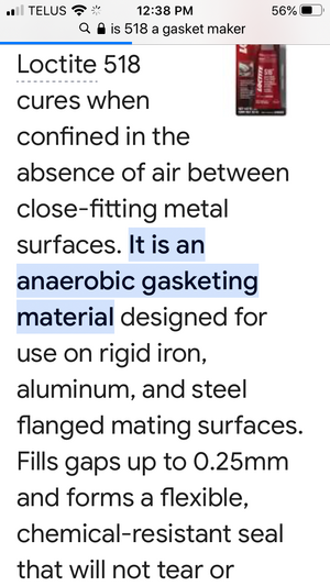

Sorry for my ignorance but what is 518?
It’s a loctite product, it supersedes 515. Permatex also has an equivalent. It’s anaerobic. Seadoo used to call for it between case halves and many still use it there as well as in many other places in the seadoo’s. What I like about it, is it doesn’t set up until the pieces have been put together and there’s no more airA7427CA2-2CCC-405B-A08E-14A530D663B5.png
