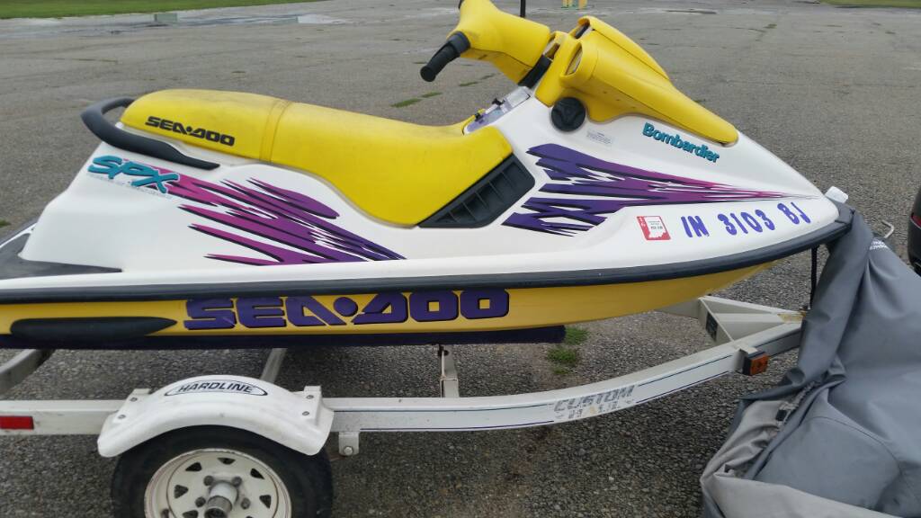

I picked up the sunken ebay SPX this morning. Here's a summary of what I've found:
http://pages.ebay.com/motors/link/?nav=item.view&id=161819852031&alt=web
Good:
- Hull is super clean outside with only light fading on the lower hull
- clean title
- Almost new Poppy cover
- seat will clean up nicely with minimal mildew staining
- 9 month old AGM battery (hoping it can be revived on the charger)
- most electrical connections appear clean after disconecting.
- MPEM appears to have been water tight so will have to test soon
Bad:
- Didn't realize the SPX came with only a gas gauge [emoji19]
- definitely spent some time completely under water as the inside is covered in mud/silt.
- Due to above there is no shot at saving the engine
- Battery was still connected so lessens likelihood of electronics working after cleanup.
