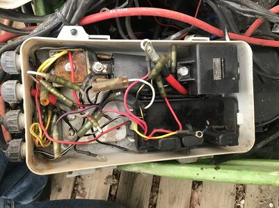

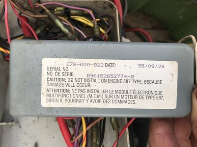

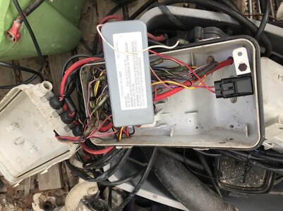

Not sure but the MPEM has a warning that says "NOT to use it in 587 skis." :) I have 2 like that. :)
I think that warning means that if you install that MPEM on a 587 the rev limiter will be set too high and blow up the engine. That rev limiter is probably 7000 RPM the 587 should be set at about 6500 RPM.
