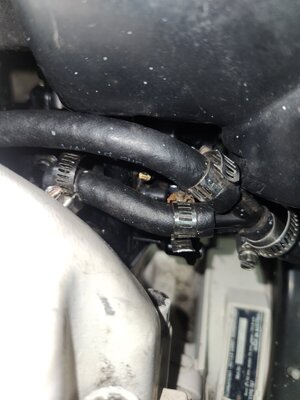

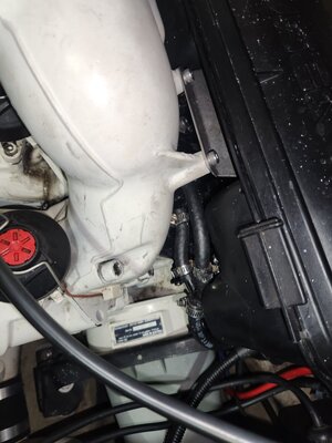

Good afternoon everyone,
I recently rebuilt the carbs and looked up the tuning for the my model(1997 SPX 787). The tuning sheet in the forum says that my HI should be tuned to MAG-0 PT 1/2, but for the 96 model it's just 0. I was informed this changed is due to the accelerator pump addition, however I don't see an accelerator pump on my PWC. Should I tune it then to just 0? Also why do I not have an accelerator pump if they were supposed to be on my model year? Thanks

Have a look at the link I just sent, if I remember correctly from 20 seconds ago, the mag was 0 turns out and pto was a half turn out
1997 SPX does not have an accelerator pump.
Jetting and everything is the same as a 1996 XP so just adjust to those specs, Low = 1 High = 0.
There are some mistakes on the seadoosource chart.
It will not hurt anything having the PTO carb High at 1/2 turn out as the rear cylinder can run a little hotter.
