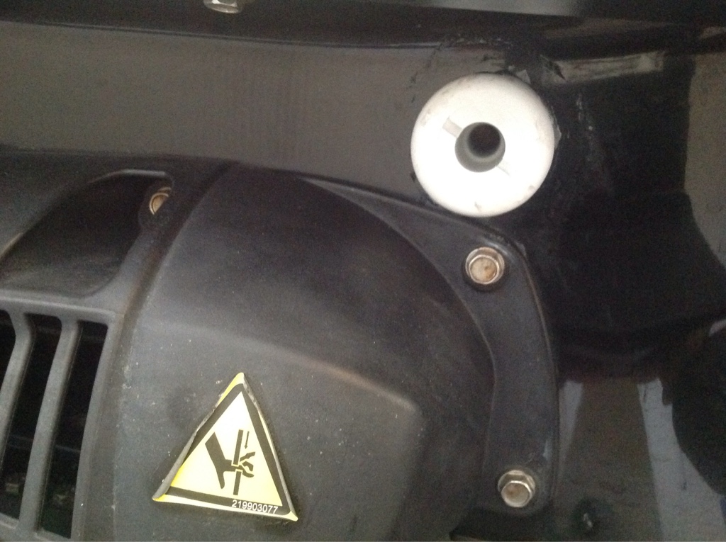

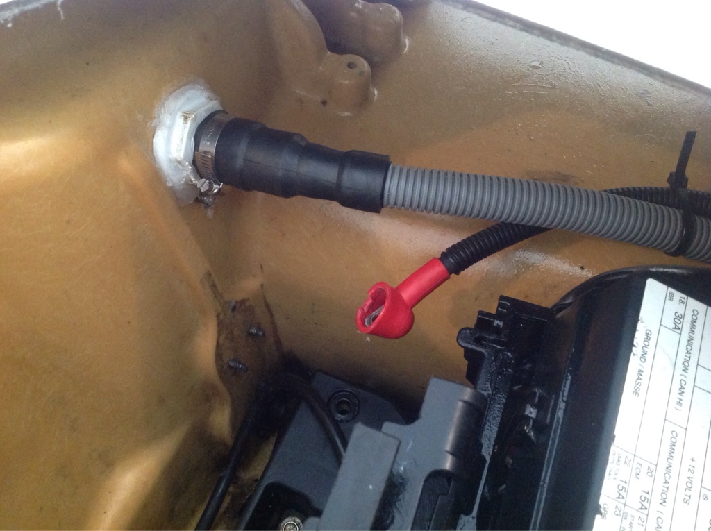

There is a template for d
rilling through the transom. The pump is actually on the port side of the ski. It sits around the 6th rib (going from memory here). The discharge points toward the stern. The discharge tubing is routed up and over the engine and expelled on the starboard side of the pump. You need to put a pinhole in the tubing (between the two pices of black tape) to break the siphon that can be created since the bilge pump is below the water line and at times, the discharge nozzle can be under water too..
