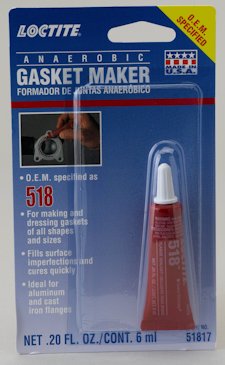

One more question, what sealing product do you typically use when installing the new plug? I have a feeling the previous owner used a thread locker. Going forward I will be doing this maintenance on my own and want to make sure i am using the right product.
Thanks again.
That requires an anaerobic sealant, either 518 Loctite or Permatex is what you seek. Some auto parts retailers offer that in reduced size tubes or one time use foil packs to save you some money you'll only need a little bit each season and it's pricey to waste a tube of it.
I wouldn't use last years sealant for that application.
I take your last statement to mean once the sealant is opened, it wont last a year, correct?
I searched for 518 anaerobic sealant and all I am finding are gasket and flange sealants. Is that what I am looking for?
Sincerely
Sincerely
Yes sir, that was originally developed for flange applications. It has a great track record sealing oil plugs in place without leaking or taking a set around the threads and cementing it in place. Anaerobic sealant cures in place without the presence of oxygen, and this formulation has both a desired gap filling ability plus resistance to petro chemicals.
Now I can't say one way or another regarding the shelf life, all these products have data and tech sheets available from the manufacturer but I can't use a tube of something in good faith that I know has been open for any length of time. Exposure to hot and cold, moisture etc why take a chance on something sealing a submerged plug thread?
Here's the smaller tube I was referencing, it's only 2/10 of an ounce there's plenty to coat the threads on several jobs during the season I'll use several of these but it's always fresh that way. I use it on all gear case oil plugs that do not have a backing gasket such as a Mercury or Yamaha outboard gear case or pressure vent plug would have.
