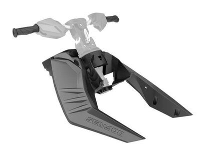

I have a 2023 Trixx 2up. I am want to replace the front Center Console plastic shell (what I call the "Front Forks"). Does anyone know if this is big job or not? I was trying to find some videos, but no luck. After a quick glance it appears i may have to remove the upper steering column, but I'm not sure yet. I was hoping to get some background knowledge before i start taking things apart.
