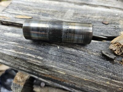

I pulled the pistons from my 787/800 project, and there was discoloration on both the connecting rod small end ID, and on the piston wrist pin (basically looks like the needle bearings cooked the oil and it burnt). This is on the PTO side piston which was the point of failure in this repair. I can probably hit it lightly with scotchbrite and it would come right out. I plan on replacing pistons/rings/pins with the kits that are available from SBT, a light hone on the cylnders(scuffing is extremely minor), clean out crankcase, reassemble lower, assemble upper with new piston kits, new gaskets, and call it a day.

I included pictures of the rod, small end, that concerns me.
Thanks again Toby.
Was going to see if scotchbright may clean the rod up

Those Rods and Pins are shot.

Yes, as said above rods/crank are toast.

Just trying to grab a few pointers for future projects, what is it that you see that tells you the rods and crank are done?
In the connecting rod small end is scoring and very mild dimples where the needle bearing pins were located.
