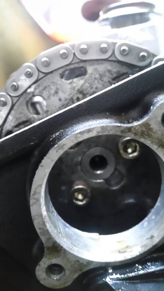

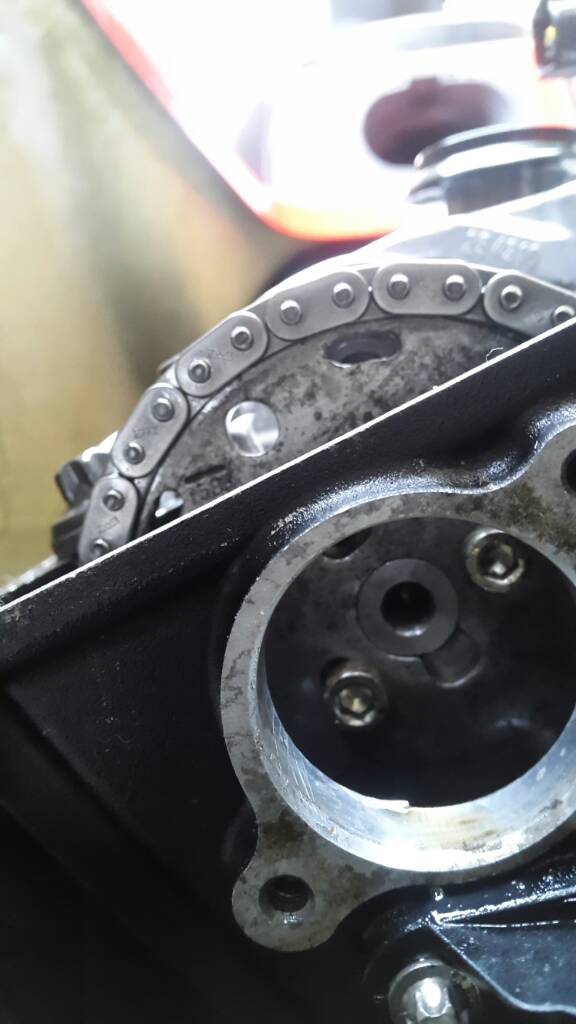

Hello to all and as allways thanks for your help and ideas to fix my problem
so here i go first a little story
bought this used gtx 110 hrs on it when i got it the first thing i noticed it was not doing more then 5000 rpm but the impeller was very bad and when cavitating it could go all the way to 6300 rpm
so new impeller and pum and wear ring all was new and again no more then 5000 rpm but no cavitation so step 1 done
i did all the things the manual said with no results even checked engine alignment electronical stuff also cheked with the computer so no error codes
BUT there is always a but isnt it
i checked the the engine compression and buum 150 psi on all 3 cilinders found the problem but (another one) i dont want to take the engine out to find out that there was another thing so before i take the engine out i had an idea the cam shaft timing might be off so i took the cover off and moved the timing it was almost fully retarded so as a test i set it to fully advanced and WOW 180 psi on each cilinder but guess what still no power max rpm 5300 and engine doesnt run nice when cold.
so before i take the engine out and spend alot of money on getting the parts and all to fully rebuild the engine do you think it is a good idea to set the timing as the manual says and look for more things or start moving the timing little by little to get the max power or what do you think i should do new timing chain??? or what i am a little frustrated to be honest
again thanks for your help and ideas
