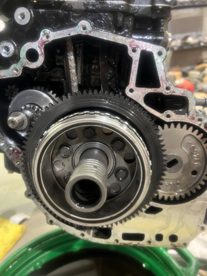

I opened up the pto again to see if anything was still off, and it still looks good to me (correct me if im wrong)

Can't tell much from your pic since I can't see the encoder gap and don't know the crank orientation. It looks like you have it right now if the encoder wheel only has 1 alignment hole.
When the encoder wheel and mag cup are misassembled, the stator can get rubbed and short it out since the encoder wheel is sitting on top of the alignment pin at an angle. Check your stator for resistance between all legs and resistance to ground.
The cps plug can get mixed up with another plug.
Trigger wheels don't go bad unless they get chewed up, they just have a gap that the cps senses when it spins. No special way to orient the cps, put it in the hole and put the bolt in.
