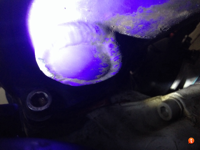

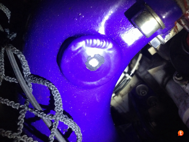

Water in the hull, you need to run the boat on the trailer with the hose hooked up. Start engine, turn on water, look for leaks, turn water off, turn engine off. I'll bet water is coming from one of the welch plugs on the main head pipe. Look low on the inside of the pipe towards the mount that comes off the Mag housing. Also post a pic of the carbon seal around the driveshaft where it exits the hull from inside the bilge. I also noticed you're missing the bumper in the end of the driveshaft on the pump side, there could be a good chance you're missing the one on the PTO side too. With out them the shaft can move forward opening the gap on the carbon seal set up, alas water intrusion.

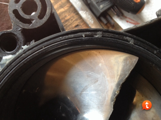

Here is what a neoprene seal looks like, it will compress and seal the front of the pump. It's hard to see but it's about a 1/4" thick foam ring.

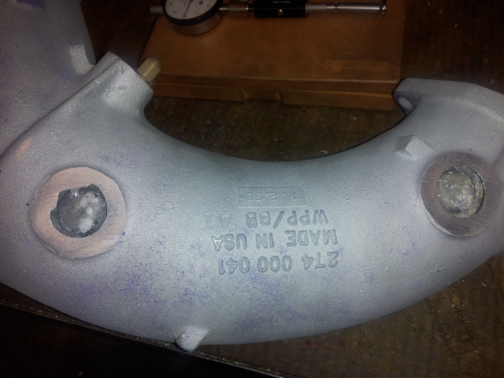

Here are the welch plugs, they rot out from the water sitting in them

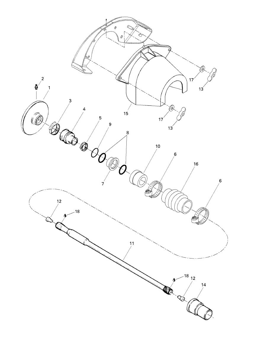

Explosion drawing for the driveshaft. If #9 is an O-ring that needs to change to the C-Clip (272000135). Also look for the bumpers #12

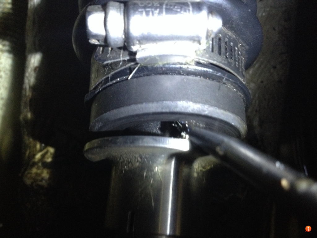

Why do you think about the carbon seal? There is no crack, no sign of deterioration?
Could you explain me the purpose of shimming the pump with stainless washer? Should i take them off when i put it back together with the neoprene seal?
The carbon ring is the black piece that is hose clamped into the bellow that the stainless ring is riding against. It looks like it's worn crooked, but it's a small pic, any chance of a larger pic?

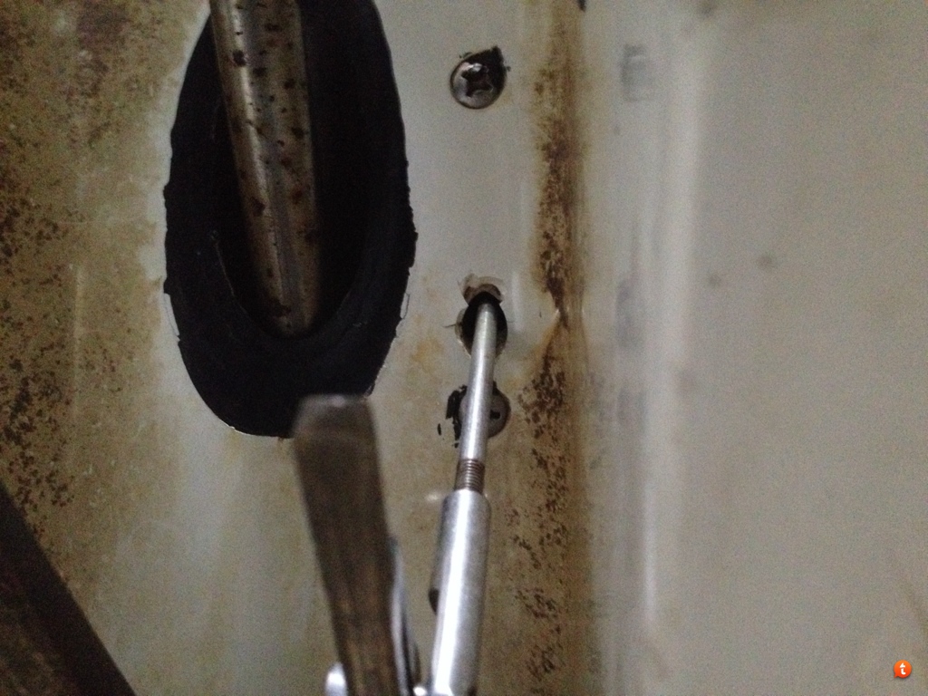

Also look at the cable for the weedless intake grate, the compression nut (black plastic) will crack allowing the cable to leak. There is a guy on Ebay that makes them from either aluminum or stainless for dirt cheap. Of just silicone the hole from the outside where the cable exits. I think teh weedless is neat, but I never used it but one time when we sucked a ski rope around the driveshaft.

Here some more pictures! I did run the boat with the hose once, i will do it this morning and check for holes, but the white hose goes to the bildge pump?
