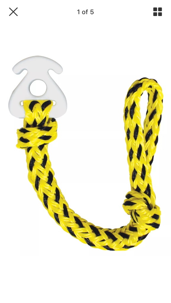

Or an adapter like this where you can tie it to the loop basically permanently and leave it there.

The yellow "adapter" that CoastieJoe posted is exactly what you need to use. I have one and use it all of the time for towing tubers. Also there is no need to tie it on permanently... just thread the rope through the solid tow ring on the boat, then loop the plastic adapter piece through the loop in the rope... this will leave the adapter sitting on the swim platform securely attached to your tow ring... and completely removable.

Nope, that is the standard ring for that model/year. Ours has the same on it. If you choose to tow from that ring, rather than the pylon, go with the yellow adapter as stated above. It will be the easiest to use and take off with no knots as described. Don't bother with the cleats on the side.

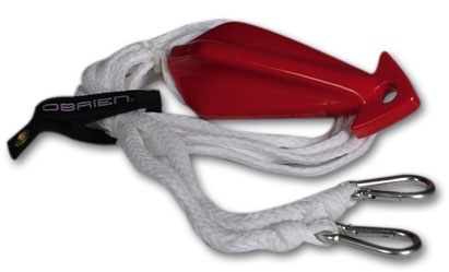

I use a Booster-Ball when towing tubes, it works great for keeping the rope out of the wake!
I use one too. I like it for keeping the rope clear but I like it even more for visibility. The lake we go to is pretty busy. You cannot mistake that there is some one being towed with the bright colours and size
