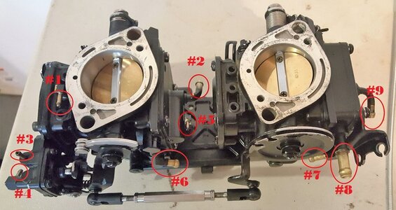

wesleypipes Member Jul 18, 2024 #1 I'm so close to finishing my rebuild of my 1998 GTX Limited I'm looking for the bung on the crank case to connect the carburetor to, can anyone shed some light on where it is?
wesleypipes Member Jul 19, 2024 #2 to be clear it is the #9 on this picture on the carb that should go to the lower crank case, I just cant find the connection on the crank case. Attachments 20160620_183125.jpg 118.5 KB · Views: 3
tobytd Well-Known Member Jul 19, 2024 #3 “bung is low on pto cyl. There are 2. 1 for carbs (fuel pump) 1 with a check valve to RAVE solenoid
