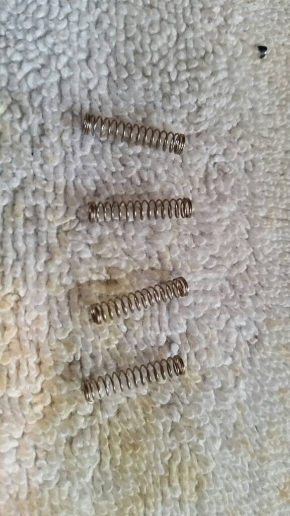

Trouble is when you get something used how can you tell the factory spring is in fact whats in there. I had a separate thread asking about the stock springs and it may be hard to tell if they're factory or not. These are the originals I pulled out, which I will give a shot at putting them back in.
q+t. If the manual calls for 38 +- 12, according to the chart above would the black springs come stock?
Your target pop-off is 38 psi, so you'll need to install 80 gram black springs in conjunction with 1.5mm needle and seats to get there.
What you removed originally in your picture are 65 gram springs, which is likely what you used from the kit to replace them with the test results you got. It's not uncommon to see 65's in place of the original counter wound 95's that BRP shipped the boat with.
