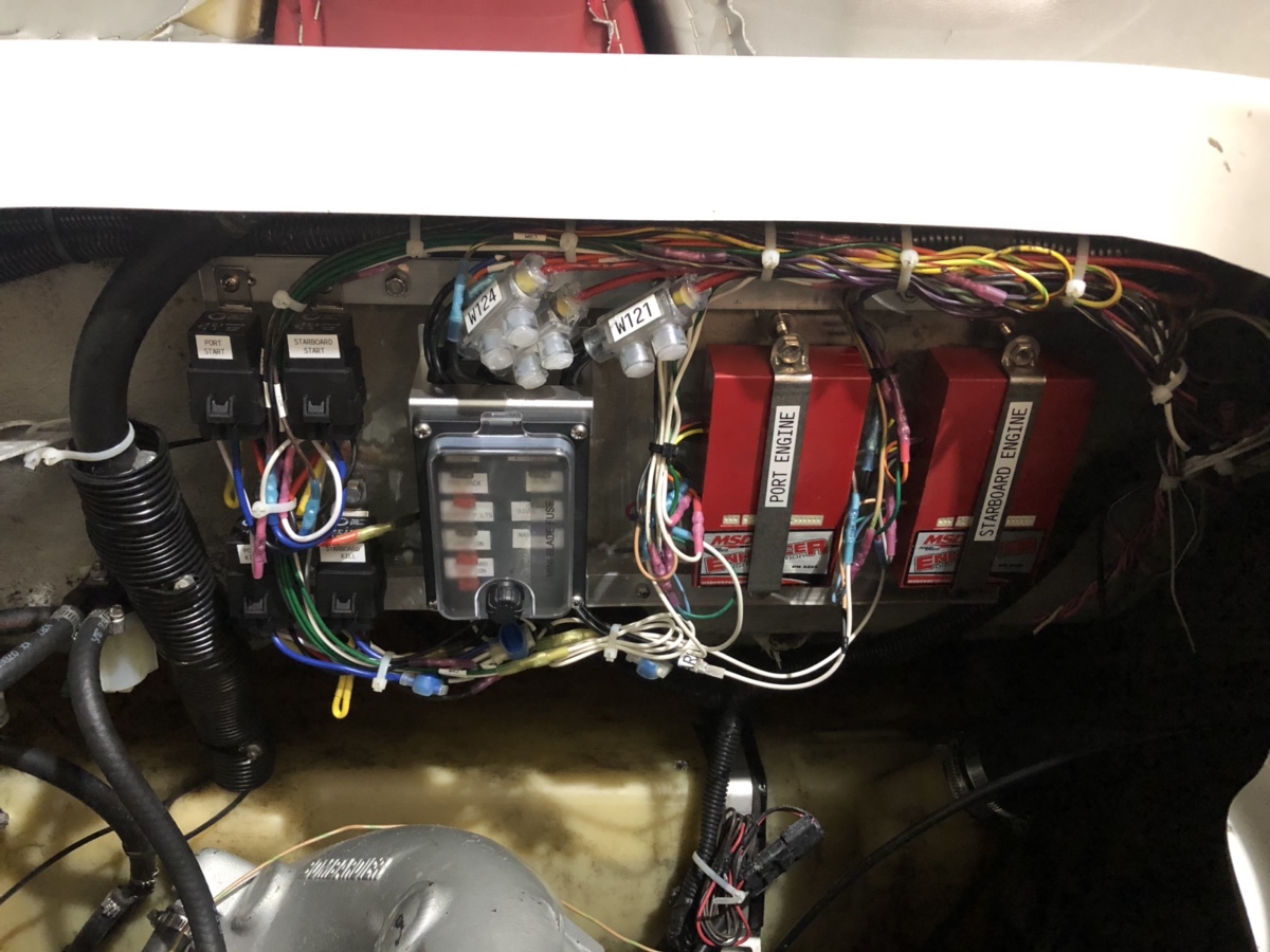

This is my finished version of my mpem rip out on my 99 challenger 1800. My mpem stoped working on the port side when I bought it, so I bypassed the mpem with a 4255. This year after replacing the rave valves it finally gave up the ghost and wouldn’t start the port engine or starboard without shutting g the main power off.
So I ripped it out. I just took the boat out last weekend and she runs beautifully.

Where did you get the fuse block?

When you setup these 4255s, did you just use the MSD recommended stock settings? Cool setup.. how did it run this last summer?
