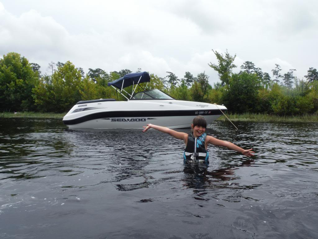

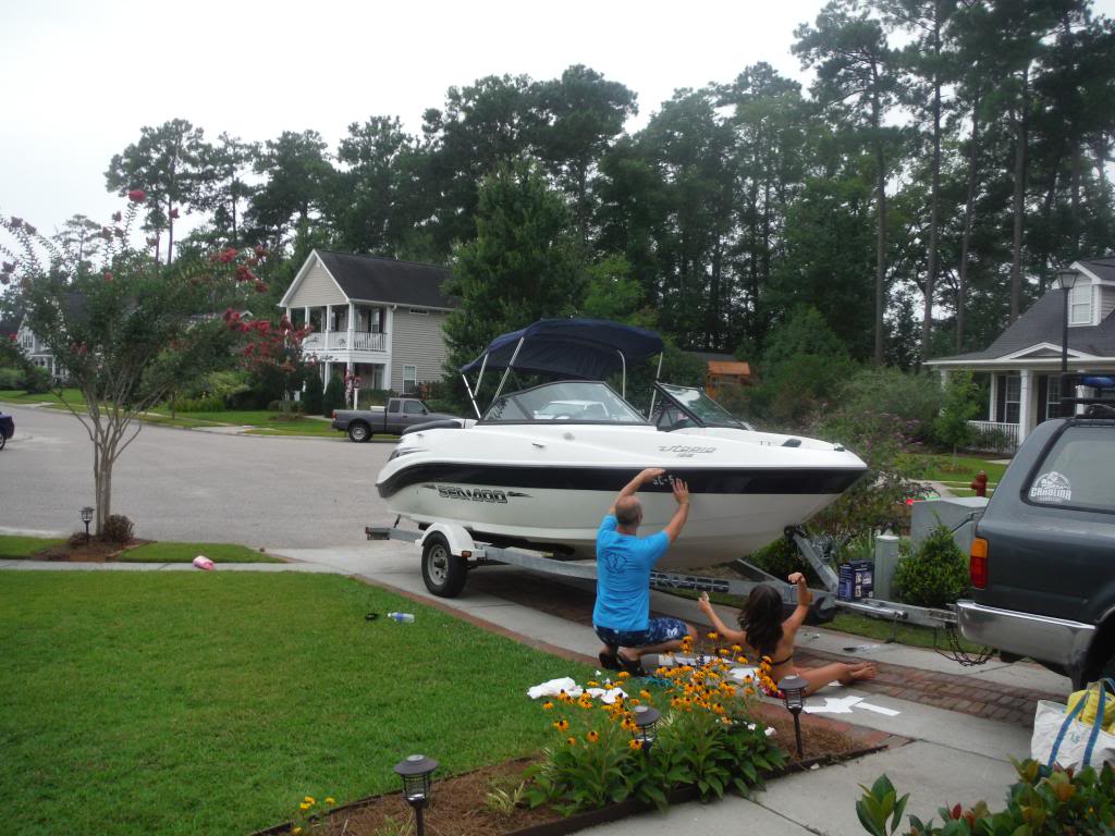

Drove up and test drove it! Had the chance to check it out while it was still on the trailer. One small patch job over a ding in the glass on the bottom. No big deal. No hydrosurge grate, so that is a plus!
Put it in the water and it started right up. Test drive went well. Everything worked with small minor cosmetic issues. Engine sounded great and was responsive, Steering was true, even at low speeds.
The only problem was that my truck started to overheat in the mountains on the way home! (But we made it!)
So... I am now a Utopia owner!
