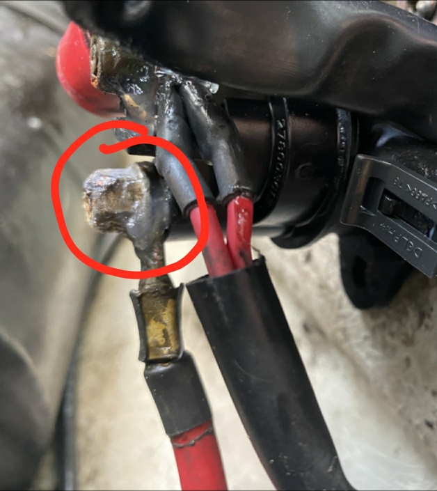

Could simply be one of the connectors going into the solenoid or somewhere else (like the one you pictured with some melting). No clue, but start at the battery and work your way towards the ecu. Will take some time, but you'll eventually find it.
That wiring is not new and neither is the solenoid judging by the bolts.
Those cable end are disgusting. The one doesn't even look like it's tight. It's start with making that right. You could remove all the cables, tape them up, and check continuity of the solenoid with a meter by pressing the start button.![]()
