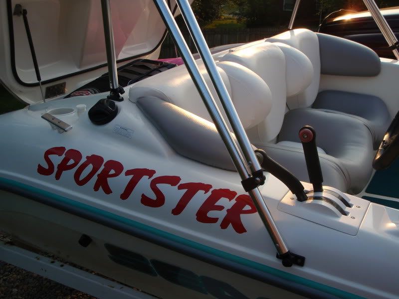

Originally, I was going to mount mine on the top flats, but after I started looking, and test fitting... I figured it would get in the way of the arm rests, and controls... so I decided to mount it on the sides of the hull. The frame is very flexible, so mounting it on a wider sport wasn't any issue... but the side tubes now hit the hull, before the top sits flat on the deck lid. Because of that... I couldn't fold it back if I didn't want it up. I had to remove it from the boat. That's not a big deal, but it takes 2 people to hold it.

This may not help totally with your boat... but here's a good pic of my mounting points.
Both the main tubes, and the rear supports are on with thumb screws. It takes about 2 minutes to take it off.
