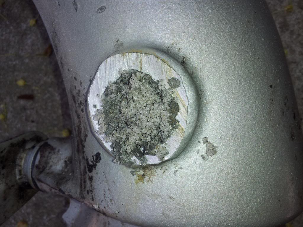

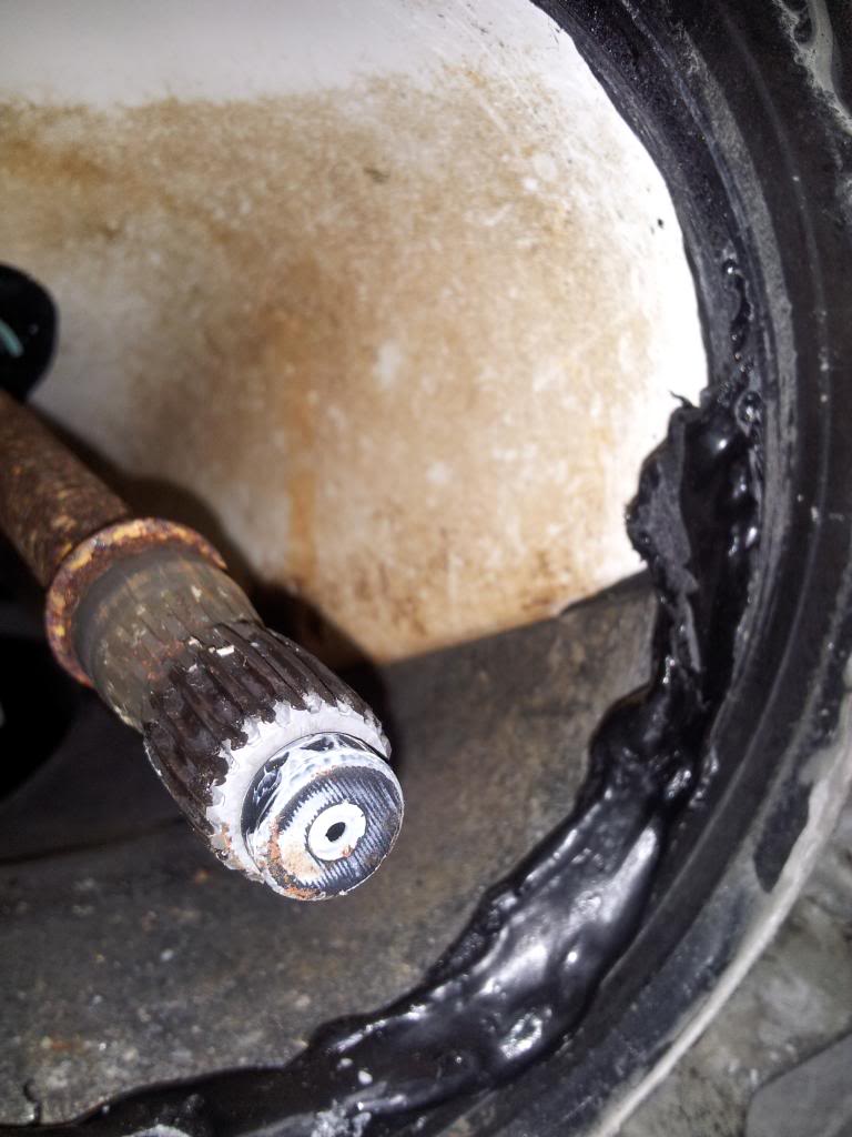

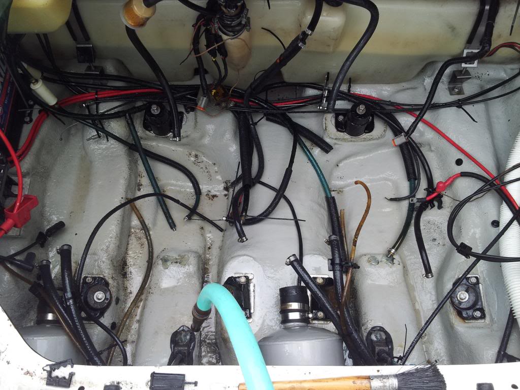

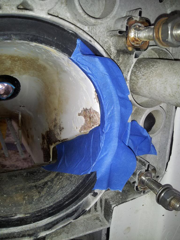

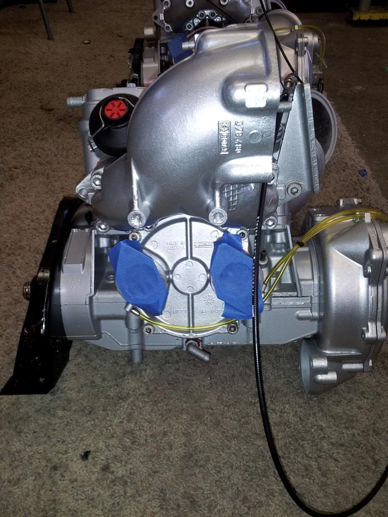

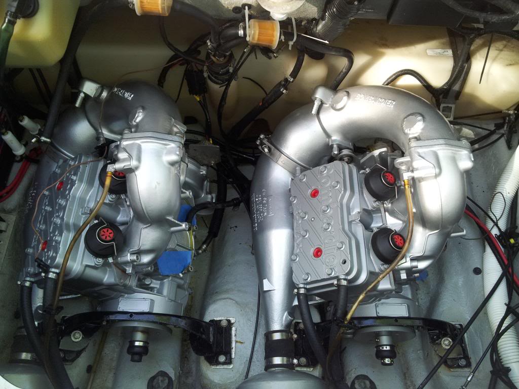

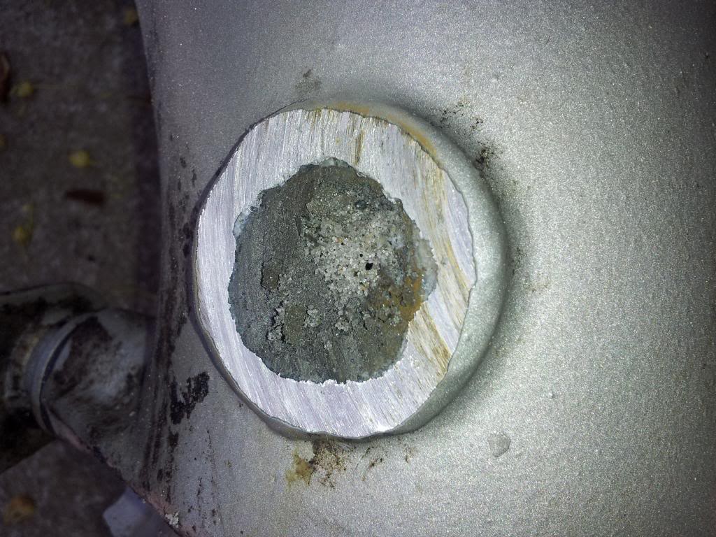

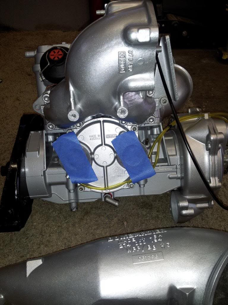

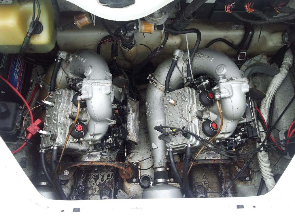

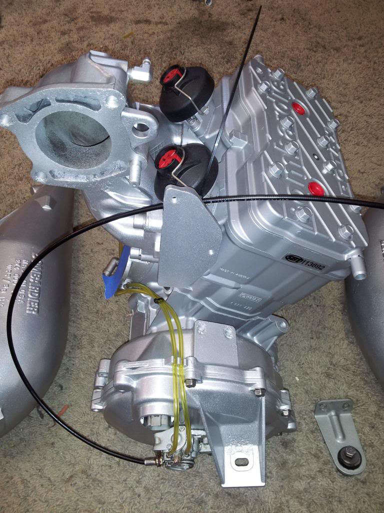

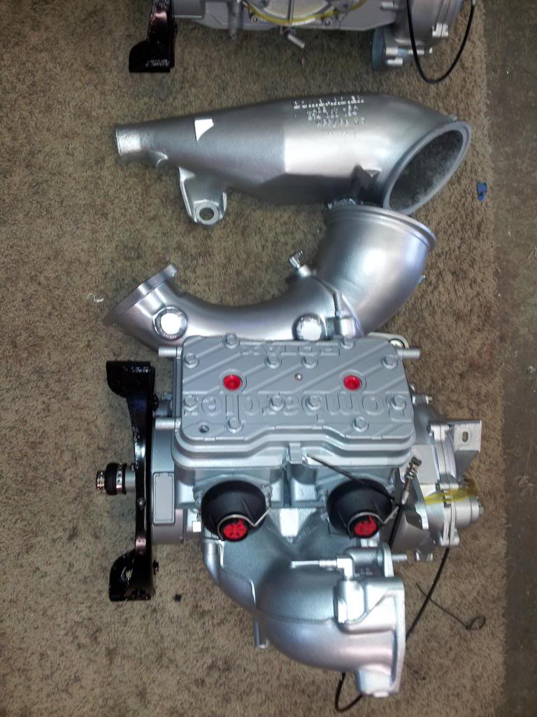

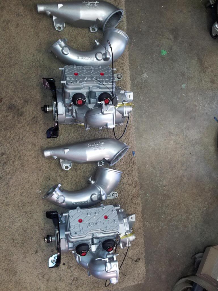

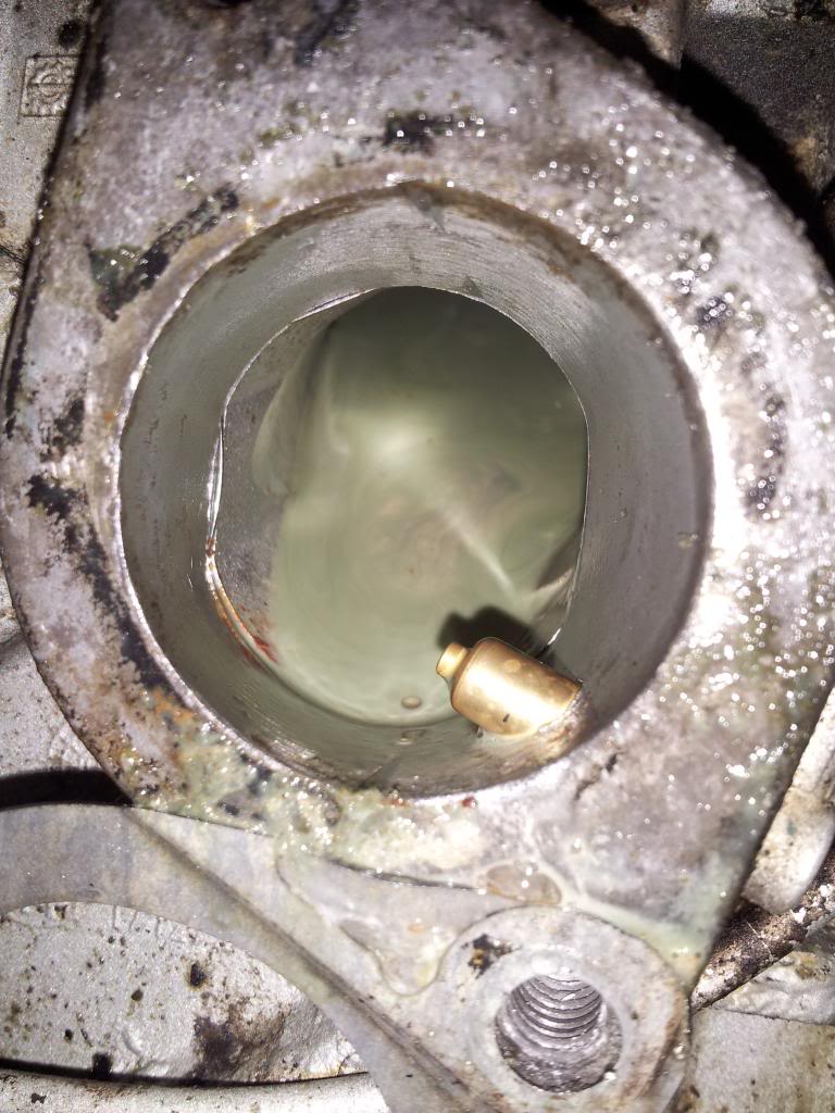

Ok, so here's the skinny. PSuter contacts me through the forum, Ha, I actually already knew him and he's a great guy and want his boat fixed up. Typical "It needs a starter", wrong. I ended up installing two new SBT 787, rebuilt the jet pumps, new Solas COncord 15/23 impellers(friggin' sweet BTW--Thanks [MENTION=58005]Pale Rider[/MENTION]), new OEM wear rings, OSDparts heavy duty carbon seal kit (friggin' sweet BTW), rebuilt the carbs, fuel lines, filters, clamps, and accelerator pumps, ground all 8 welch plugs on the pipes (7 out of 8 were wasted), New water control valves and the list kept growing. But in the end, it looks great and runs good. As PSuter mentioned we still have a few little details to iron out but it was great to get the beast out today, in the light rain/mist.

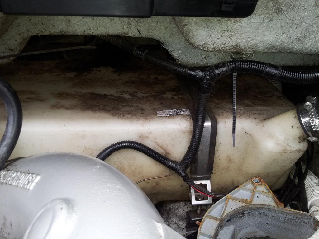

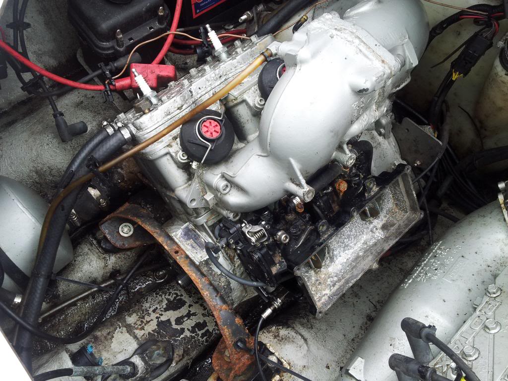

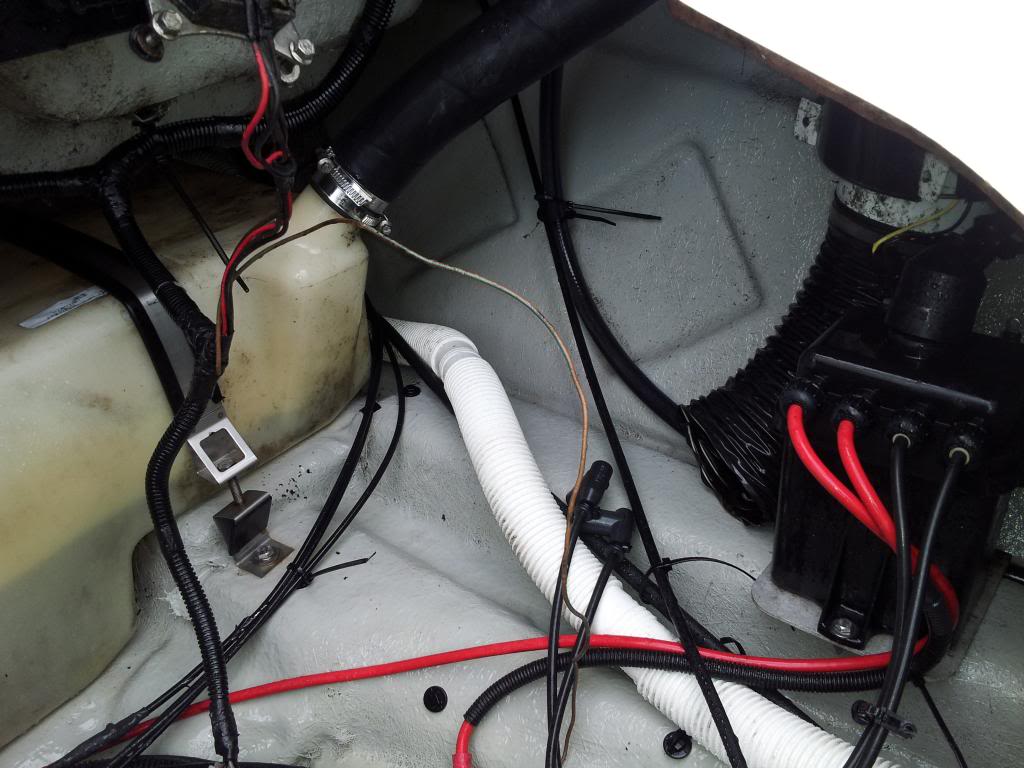

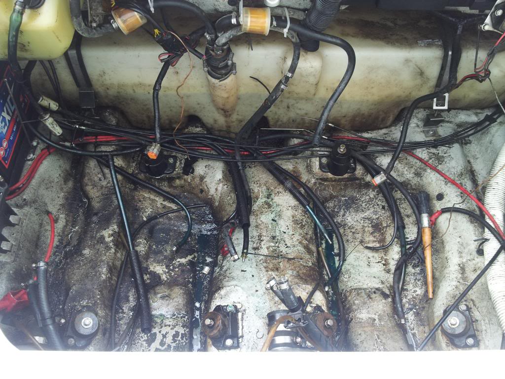

Nice and well kept by the previous owner
Exhaust pipe repair, nice and packed with sand.

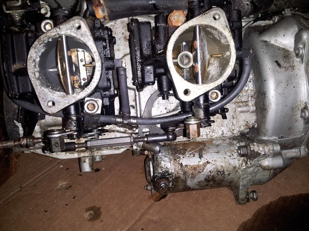

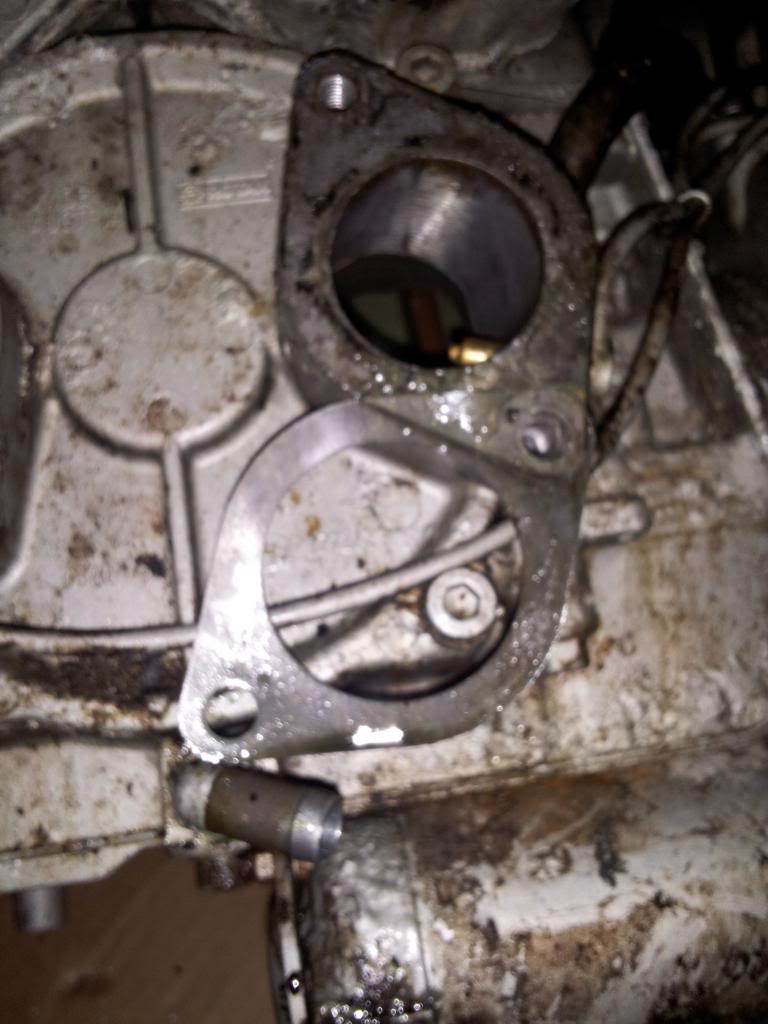

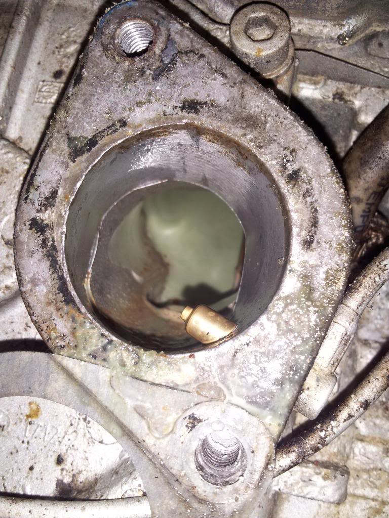

Look for the carb gasket......
The carb doesn't need a gasket all the way under it, right? That's how it was when I took it apart, just lovely.

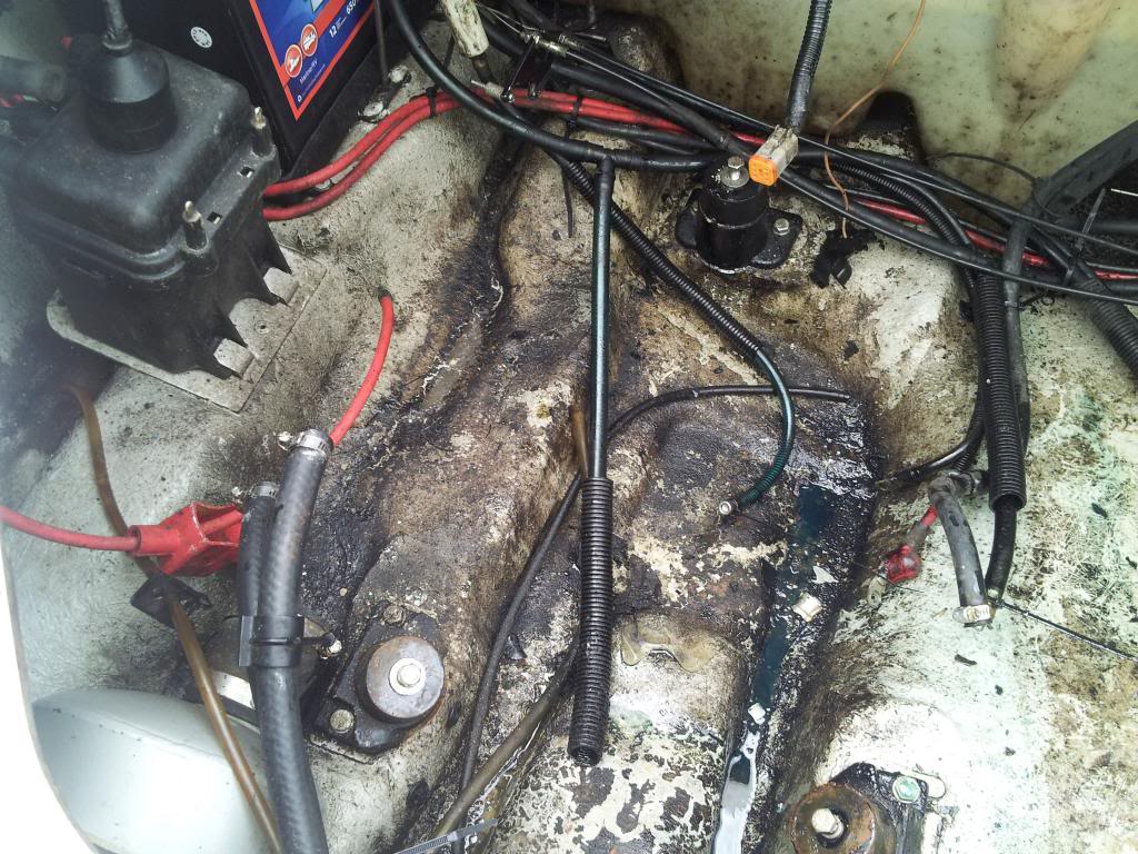

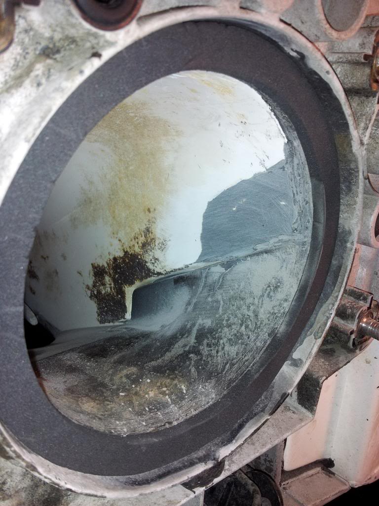

You want fries with that shake? Yep, a full bottom end with water. Only needed a starter.

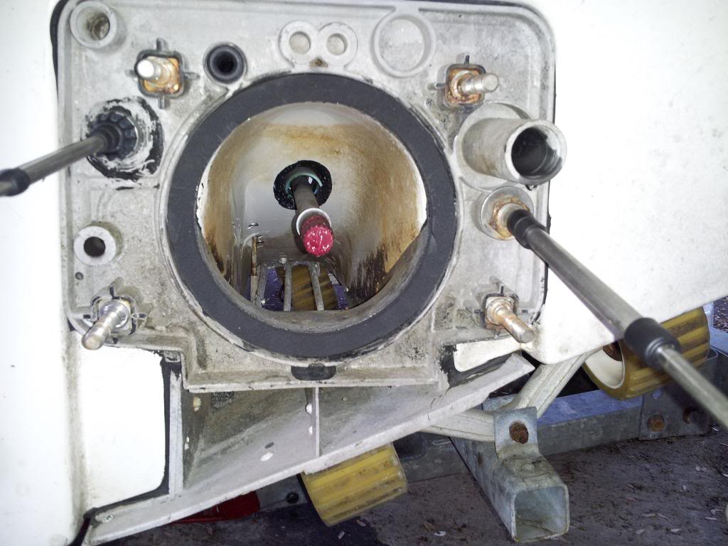

Now to the AWESOME PUMPS!!!!!!!!!!!
I swear the PO was mixing cement with this thing.

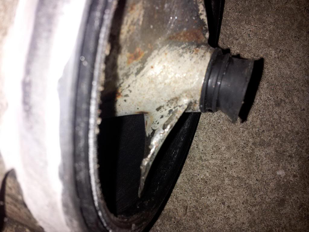

WTF is that??????? Yep, melted wear ring-- I kid you not!
This wasn't even on the side with the wear ring melt down, a little marine tex and were just like new again!

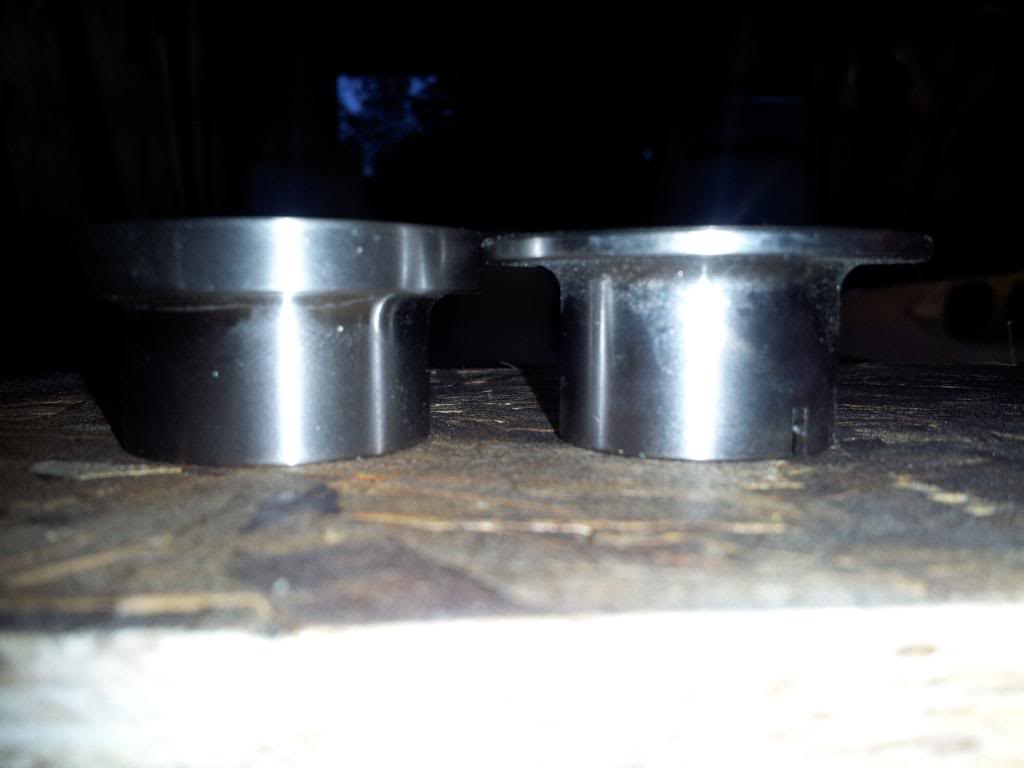

Nice heavy duty carbon seal set up, super nice parts.

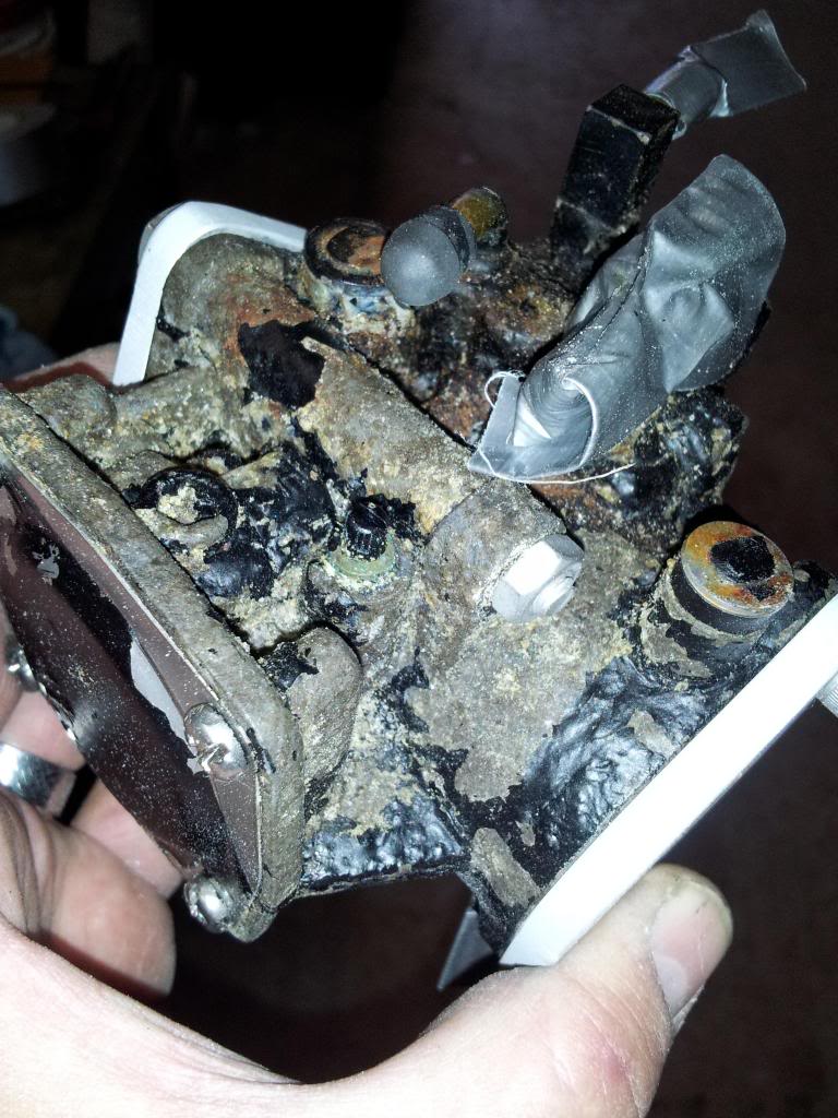

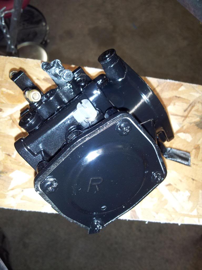

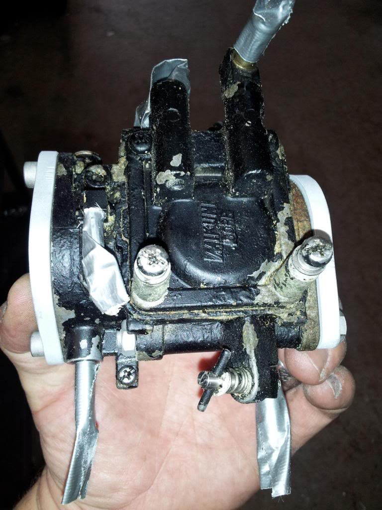

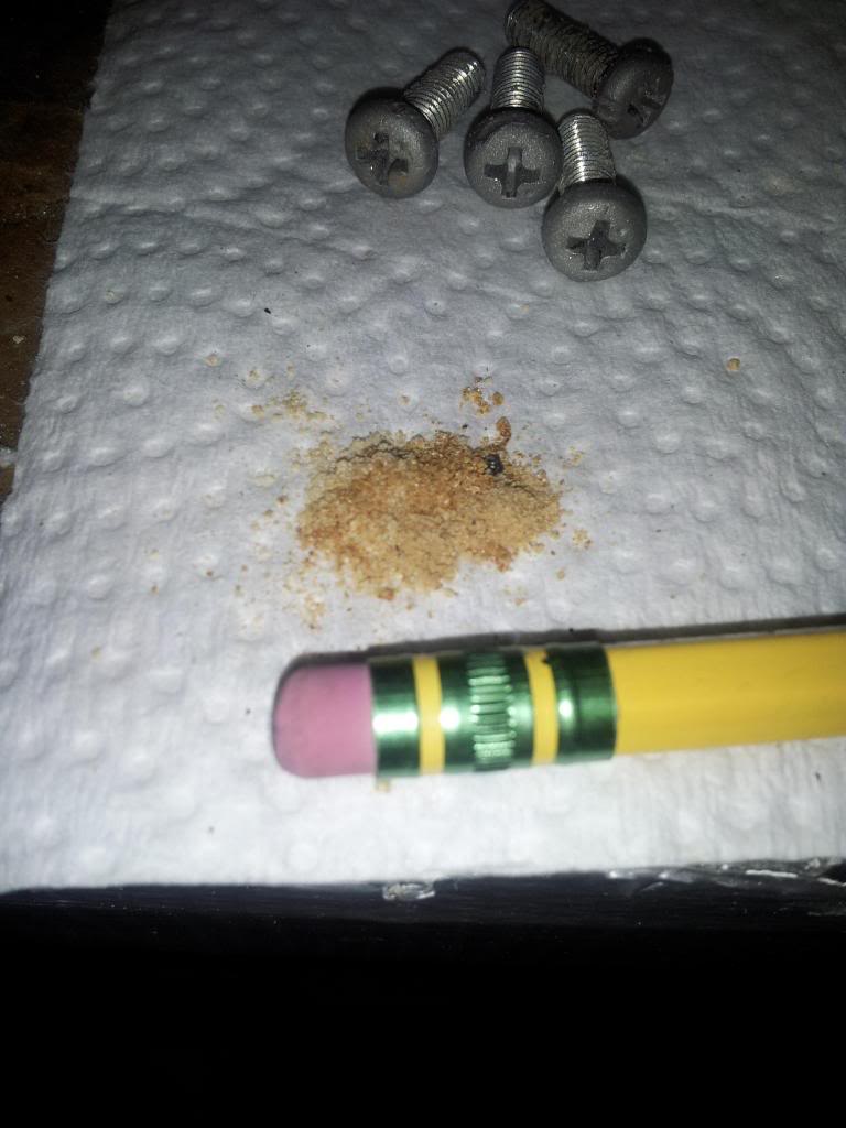

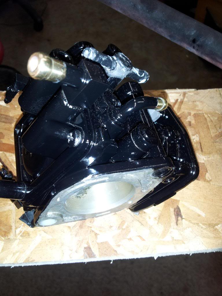

Carb resto. The one that is packed with the crack rocks in the filter actually was from the one running engine. That filter was PACKED FULL. Of course they got cleaned, rebuilt, blasted and painted. Now they look cherry!
When I sort out more of the pics I'll try and post them up. All this work was done in a little more than a months time. This is done in my spare time and late nights. Seeing these guys happy to get their boat on the water today was awesome to say the least. We have a few small things to get working like the horn and the bilge to shut off and adjust the port throttle cable and we should be good to go.
