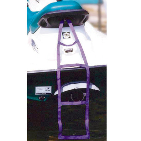

I also thought I might make something like this:
... but it would have to hang from the center mounted ring above the swim platform, which would put it directly over my jet drive.
Of course, if I can confirm that my hull has the aluminum plate in the glass to support a bolt-on ladder, then I'll likely keep an eye on this thread and do whatever you end up finding that works. :)
well for starters, when that strap gets wet it will stretch, if you slip your foot/toe can get hurt from the linkage... just looking out for ya brotha!:cheers:
rope or strap ladders need top be on the "side" of the boat so when you step on them you don`t wind up under anything. your body weight will push the ladder under the boat... those types are used for the sides, where you have the height of the boat...
if your going to do something like that, try boarding from the side...
