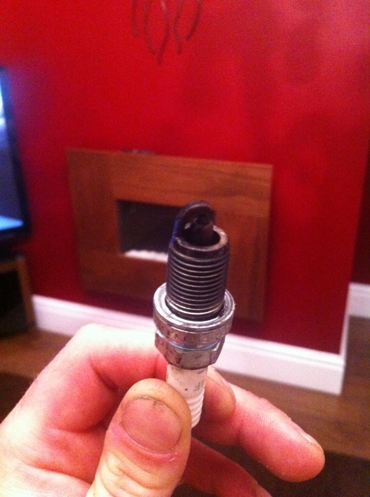

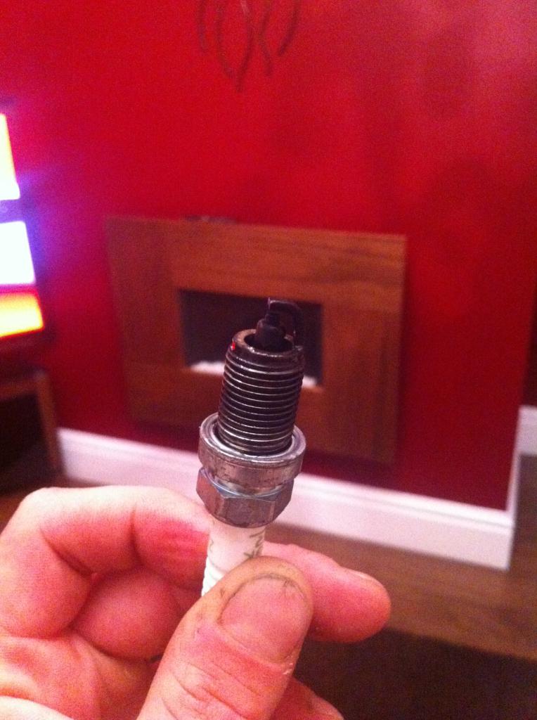

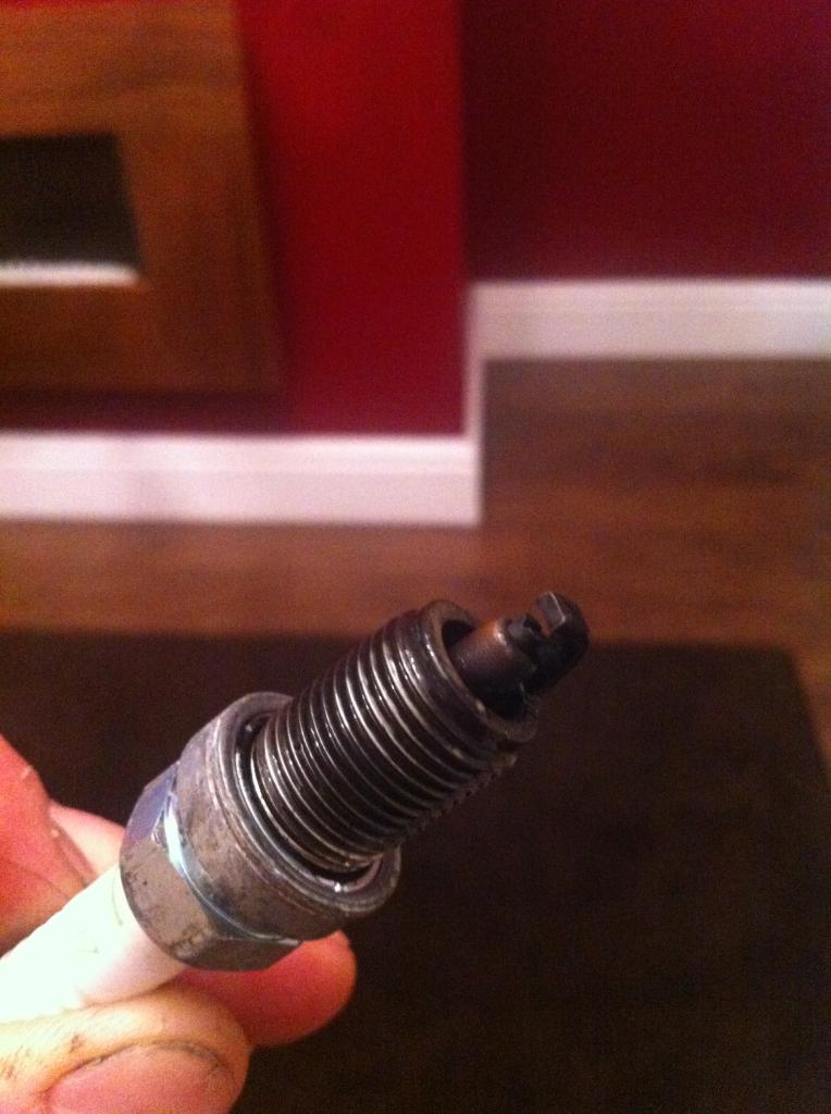

Took the brand new plugs out to inspect, they look sort of blank.
Any ideas what's going on guys?
I see mocha on those plugs. Maybe a tad dark but they look good.
That can't be the right oring for the RAVE

You don't want to see white or grey or black, the cardboard brown(mocha) color is the normal oil film and that's what you want to see in any two-stroke that uses API-TC oil for lube.
What I think I know, until proven wrong by someone smarter than me:
If you see black, it's likely fuel soot from too much fuel, could be wrong type of oil or too much oil, IMO most often black is too much fuel. Gray is aluminum from your piston and very bad news! White is probably impossible but it's bad news too, plug is wrong heat range or the cylinder is not firing and washing the plug clean with fuel while causing cylinder damage due to dead cylinder.
So is that a normal looking plug then?
If so what could be causing these hard starting issues and bad misfiring?
Huge thanks guys :)

Yes, the oil's additive package is what causes our mocha brown color, and grey insulators in a 2-stroke always make me nervous b/c I've seen this many times and the result was not constructive.
Huge thanks guys :)
It is very close to normal but as Adam mentioned it's a little on the dark side. I'm guessing the plug was not quite reaching normal operating temperature and some fuel soot is causing the slightly darker color.
This would be consistent with your symptom of an ignition miss, for which I gave some ideas in the above post.
