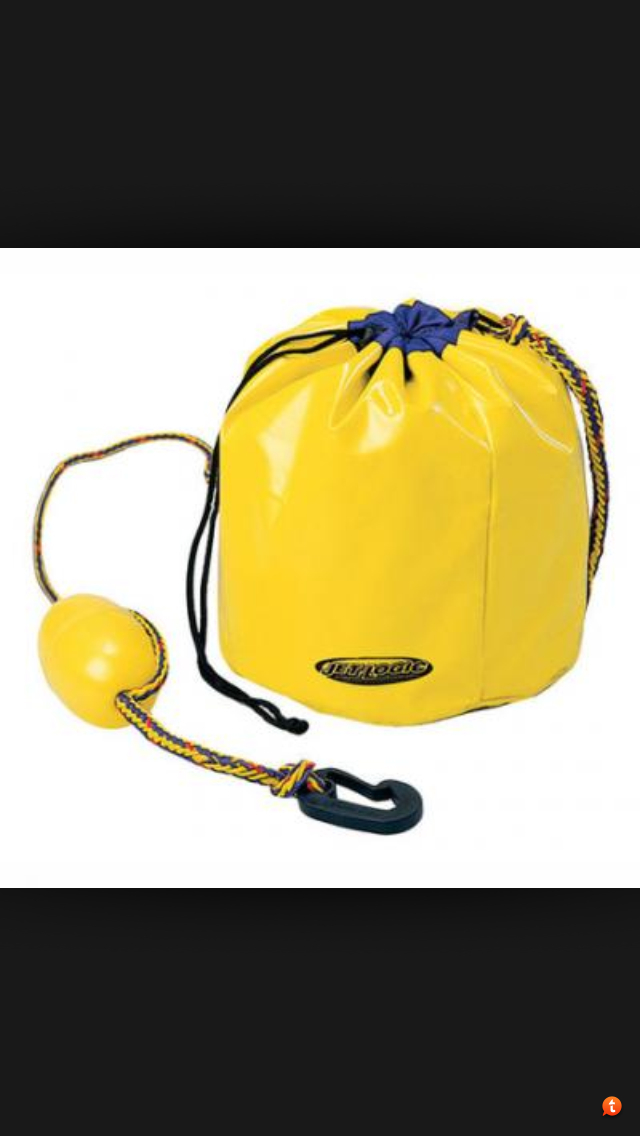

So I've decided to try a couple different styles, I'm gonna purchase the rope and buoy marker online and then go to a pet store and find the screw in stake dealio first.
Then for the sand pits where my friends and I chill a lot (no current or wake) I'm gonna purchase the bag type that can be filled with sand or rocks. Something similar like in the pic below...

That should work. I have recently discovered one called COOPER ANCHOR. It is around 60 bucks. But it is a nylon material and won't hurl your ski bouncing around in the storage compartment. I'm doing research on it, but so far nothing bad to report.

I figured sense I could get the 2 different style anchors I mentioned above for about 20 bucks less that I would go that route first. I would like to try the cooper in the near future though
