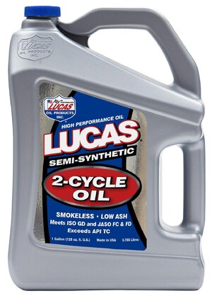

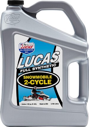

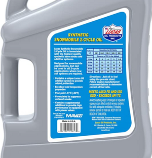

Is this the one were all talking about? The safe to use oil? LOL
Thanks
If that’s a 787 should run full synthetic, 717 that oil would be fine. I run the full synthetic in all my machines but that’s just to keep things simple instead of having different oils around
I just took a look back at an old thread, It says the semi synthetic will be fine in the 787, you will just need to clean the rave valves a little more often.
Who knows, I’ve never used anything except the XPS, I mentioned the Lucas because I was considering changing over due to the cost of the xps but if Lucas doesn’t have full synthetic I will probably stick with the xps, maybe go to the semi synthetic Lucas. I had a look online and didn’t see a full synthetic from Lucas with the API TC rating. I wouldn’t use that snowmobile oil, may be the same stuff but just so I didn’t have to worry I wouldn’t as I don’t see the rating on it. Your good with the semi synthetic Lucas with the API TC rating or the XPS. Just clean the rave valves once every season or two
