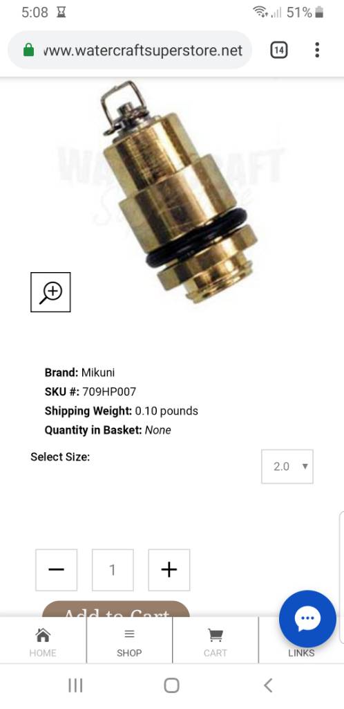

Man, I thought I did this. They both pop around 35, and drop 5 or so PSI and seem to stay put. No bubbles and pressure seems to hold. If there's no bubbles, wouldn't that also suggest they're holding? Maybe I'll just go ahead and replace the needle and seats. The mikuni kits did not come with these. And they cost $55 a piece! I would have at least expected to get those parts with it.
