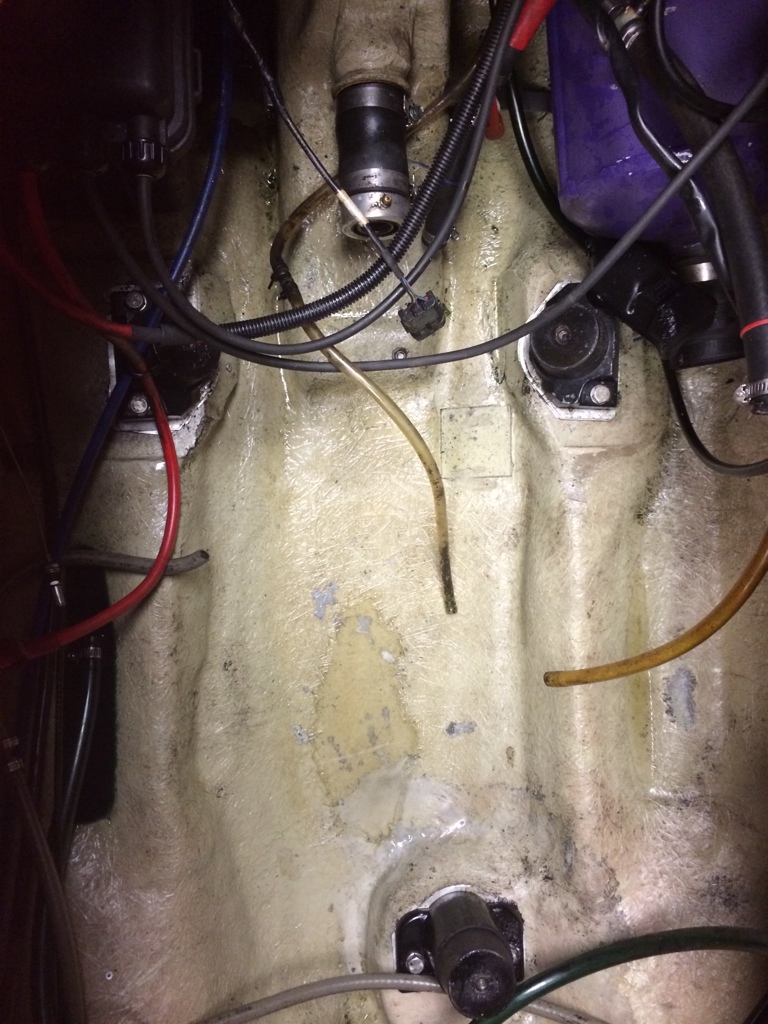

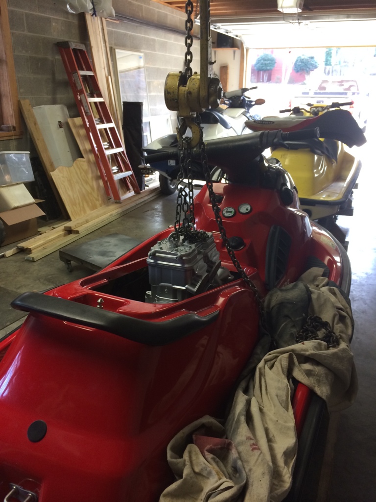

Small update: I got the motor pulled and hull cleaned up some.
. It cleaned to pretty good considering all I had was some dollar store cleaner. You can just see the hose in the top right appears to have been T'd before. I'm assuming for the front discharges

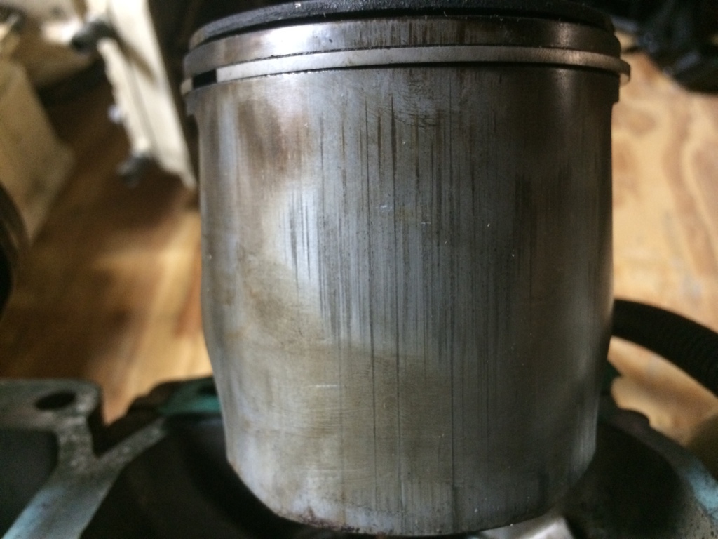

It's been a busy few weeks around here, so I haven't gotten a ton done on the ski, which has been named the RXP (for Red XP). I did get new fuel lines installed as well as get the top end of the motor pulled apart. When I got the jugs off this is what I found: MAG side
And PTO
I'd say it got a little warm! Needless to say this piston and cylinder is toast but luckily the MAG side cylinder walls were fine. I have a spare stock jug and piston laying around, so I ordered new rings and roller bearings to reassemble this motor since the MAG cylinder is still in spec. I know that a full rebuild is the best option here, but being that I don't put a ton of hours on a ski each year and this one will be getting sold in the near future, its worth the money to prolong a rebuild in this case.

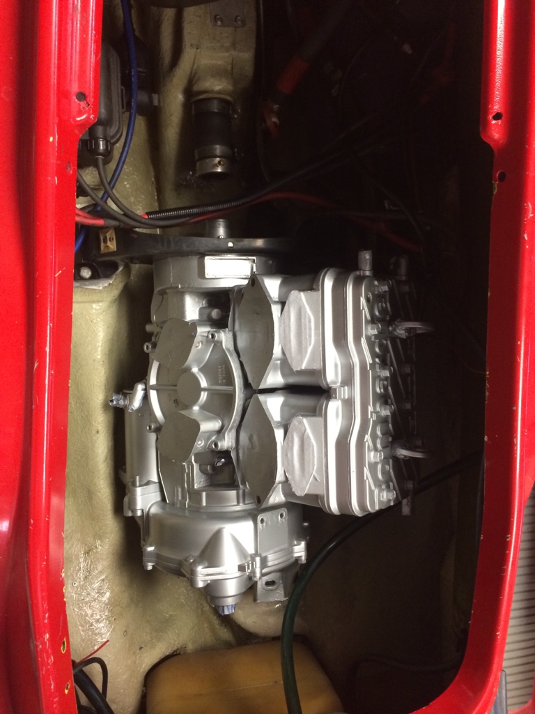

Well, nothing too exciting has happened with this build. I replaced the scored piston and cylinder with one from my parts ski that was still good. After hitting the cylinders with the hone and putting new rings in, I taped everything up and gave the motor a coat of paint
Motor waiting to go in. How's this for a (messy) garage full of X4s?
