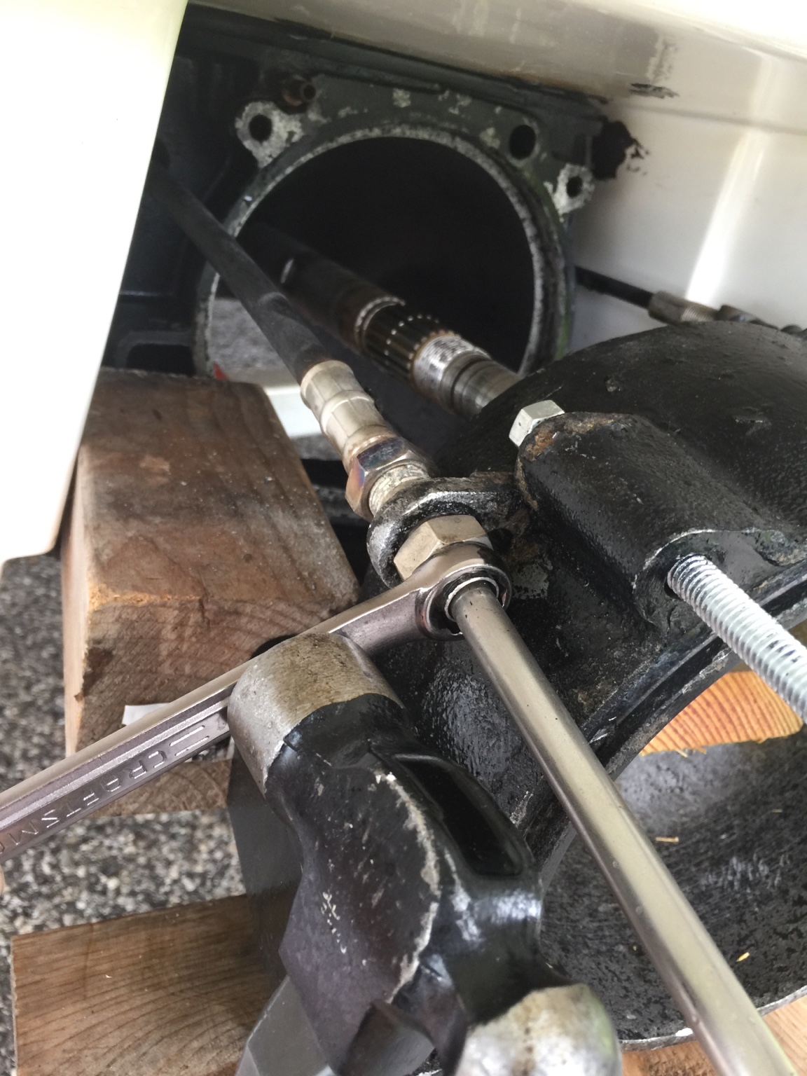

Ok. We basically did what you described. I'll attach pics later.
So when we got the wear ring off surprisingly there was no salt corrosion. Nothing like we had seen before with the other parts.
We sanded everything CLEAN but not SUPER BRIGHT & SHINEY. The instructions that came with the wear ring did not say to paint them. Oops!
I came in the house to ask you all another question.... The wear ring has been in the freezer shrinking for easier installation. The cable slid right through the hole LIKE IT SHOULD. The instructions said to put silicone grease on the o-rings of which we did... But it's still REALLY TIGHT going back together. Now I am assuming that's EXACTLY the way it should be but how do we properly get it back together? Wood and a hammer? I do not want to mess up that big o-ring!

I'll be ordering the anodes tomorrow and. . . and. . . A STEERING CABLE! :puke: It's really probably a good thing we did all of this work now! The cable separated at the crimp and the insides were rusty. We noticed the heim joint was cracked but I had planned to get that at Fastenal along with that bolt we broke off. But now I have to get a cable too. By the way I had read in another thread to use a 22mm crows foot to remove the backside stop nut for the steering cable but our front and back nuts were 7/8". I had pre-purchased the 22mm so I will return it and get a 7/8" crows foot or will we not need it now?

You missed telling me exactly how I'm supposed to remove and replace the cable. I can get claustrophobic so I'm trying to go through this procedure in my head! [emoji31]
With the pump out... it's pretty easy.
From the pump end.....
1) Pull the cable up out of the hull, so you can take the rubber seal plug off the cable jacket.
2) Cut any of the zip ties you can see holding the cable in the engine section.
3) Tape the cable ends together VERY WELL. They don't have to butted together. Just put them side to side... and wrap tape to make sure they won't come apart.
From the Helm:
4) Sit in the changing room, and disconnect the cable from the steering box.
5) Pull the cable out. If you can get someone to help feed it from the engine side... it will make life easier.
6) Cut the tape, and clean any tape residue from the cable. (sliding parts)
7) Hook up the cable to the steering.
Go back to the transom:
8) Put the rubber plug on the cable, and push it though the hull, and clamp the boot.
9) Zip tie the cable so it doesn't touch anything hot.
Once the pump is back together... hook it up to the nozzle.
You can adjust the stop nuts on either end to get the nozzle straight to the steering wheel.
