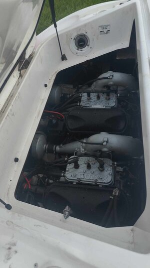

I have a Seadoo Challenger 5672 with twin 720's. The accelerator pumps are all sorts of messed up; (Needle, Pump, Spring and pin) I removed the spring and pin and bought Residual Press valves, and even new Needles. It's just not right. I know the engines were designed for it by really smart engineers etc etc. I could buy knew carbs for 250 a pop but I'm curious right now.
But for... just a curiosity let's say. I could rejet slash change the float too the following?
(This is my challengers settings I'm assuming; It's a 2000 but all the 717's are like this.)
I could go to the following settings right?
Or does someone have a better idea? Let's just assume we have to rejet/float it. Thanks.
