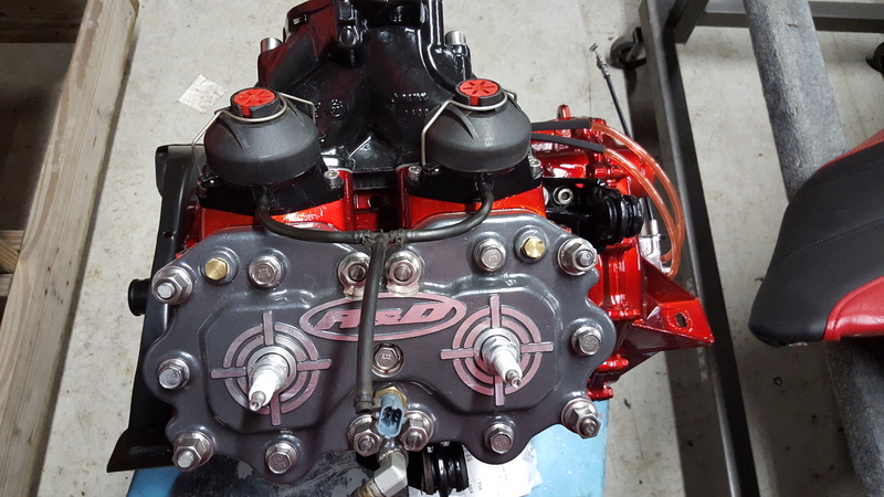

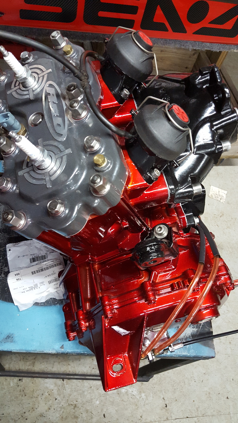

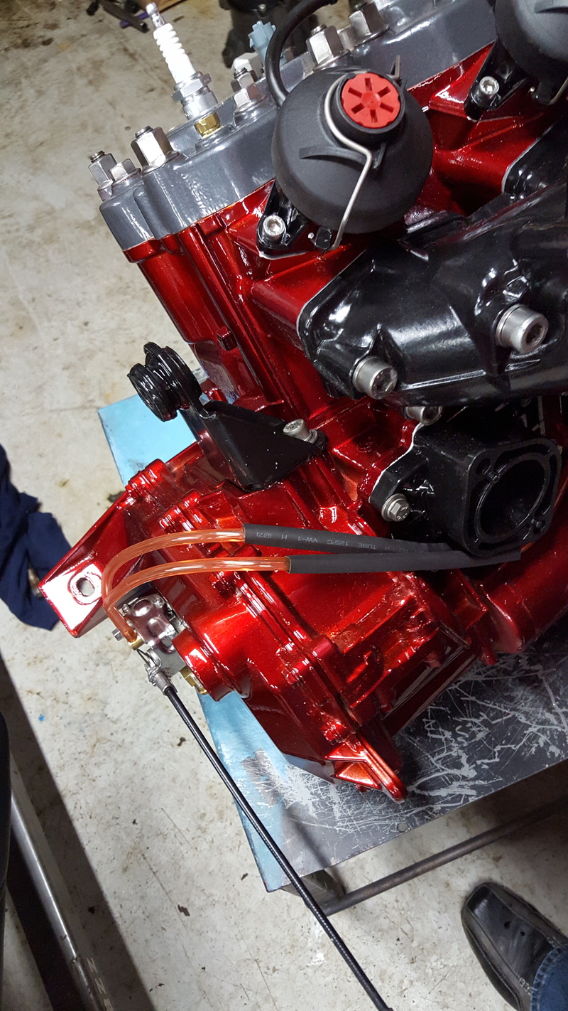

It has been a while since we posted on this. Since the post the motor was rebuilt. The pistons from the engine we got from [MENTION=51824]Matt Braley[/MENTION] were sold to [MENTION=37676]purple_people_eater[/MENTION] , they were oem single ring racing pistons. We had the cylinders bored at lakes powersports to fit the new pistons that were in the original motor. The crank got new bearings, all the seals and gaskets were replaced too. New reeds were ordered, and the motor was painted.
The color is actually a blood red with alot of flake in it, my camera wont capture it though.
The exhaust was all painted black

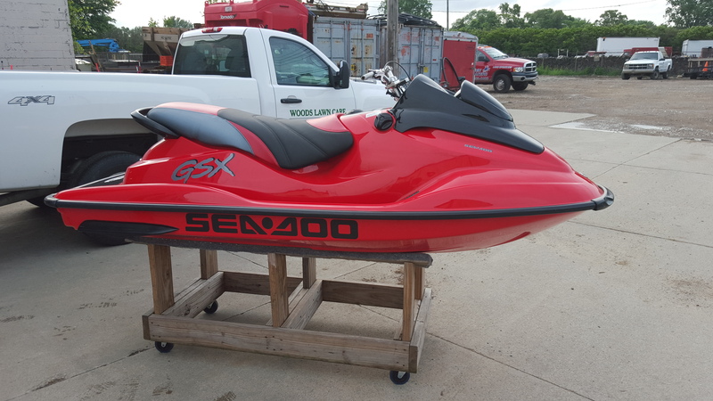

The hood should be back tomorrow. We got a few sneak peak pictures of it today
and i was very glad to get them, thanks a lot, i now have a set for my xpl build.

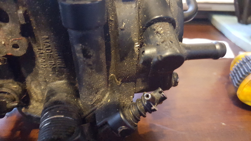

Started to work on the carbs. This is the bracket for the air box. It was nasty. I used bartenders helper to clean it
We bought a second set of carbs for $75 on ebay because the pump T nipple was broken.
The rest of the original carbs were in decent shape besides the filters.

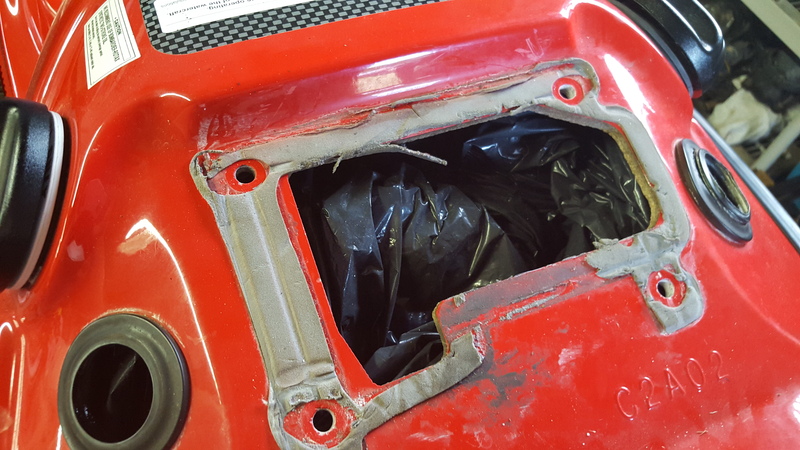

Went to bolt on the umi and the opening is not quite large enough. We trimmed about 1/2 off the lower long side. Almost down to where it dips. We just used a angle grinder with a cutoff wheel. It went fast and easy.
We covered the engine with plastic as well as filling under the area we were cutting with plastic

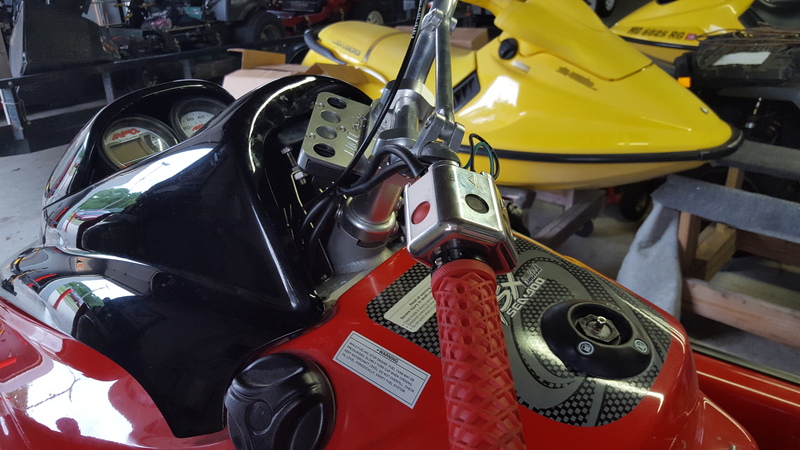

We also bought a new PJS 3 button holder. Looks just like the umi. It was $125 on ebay.
We cleaned up the umi stem. The bars are pitted and will be replaced with black bars. We did put the finger throttle, button holder and grips on though until the new bars are ordered.
These were taken just before we cut the opening for the steering larger. We did it outside so all the fiberglass wasnt flying around the inside of the shop.

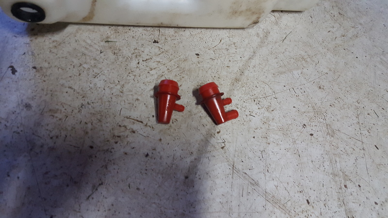

At the end of the 1 hr ride we head to shore, pull the seat and there is 3 inches of water. No water made it to the carbs. It went on the trailer and after we drained all the water we backed the trailer in to water and started it. We looked for leaks at all the exhaust and hose joints. There were no leaks we could see. Water was filling back up though slowly. Checked the carbon ring and that looked fine as well. We flipped over the bailers and one was pouring water in. Now we made sure the hose was hung up high, it was. Checked the 90 fitting and it was clean and had no blockage. Check the pump and one of the plastic tubes was missing. So of course we didnt bring one of those. So a quick fix was to remove the plastic bailer part, run the tube out the back by the grab bar. We zipped it down to the grab bar and put the seat on. It was now pissing water out that line and it looked like a second pee tell. It would have a stronger stream the more throttle you applied.
