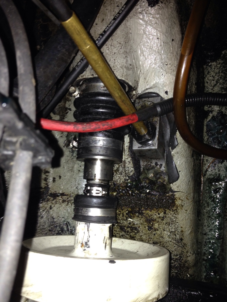

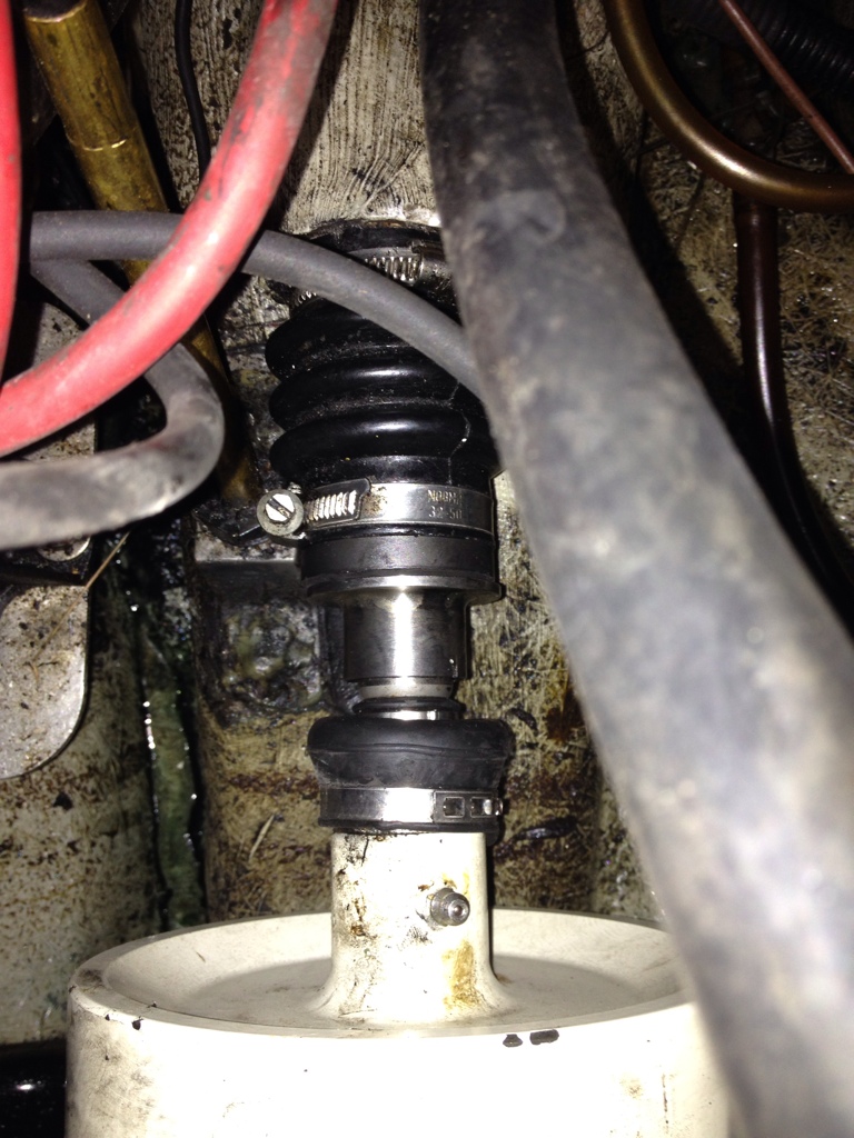

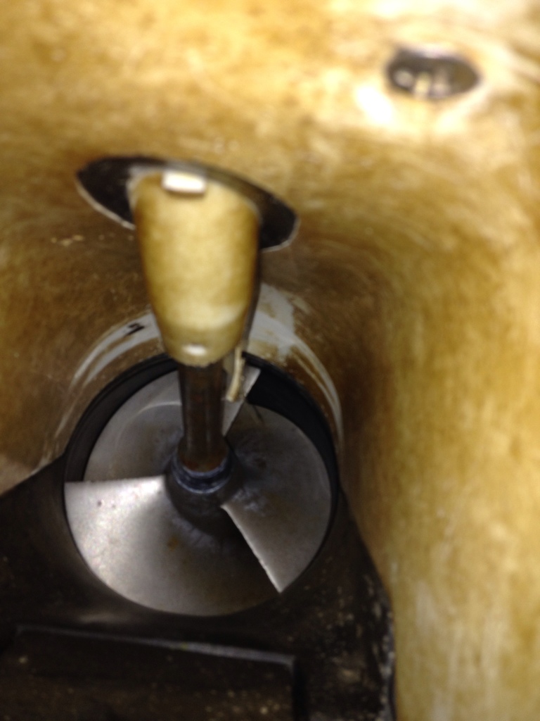

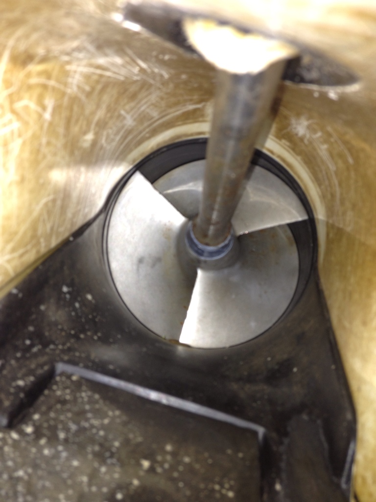

ok I have taken some pictures can you tell me if things look normal from the outside
Starboard side
Starboard side Impeller
Port Side
Port Side Imperller
