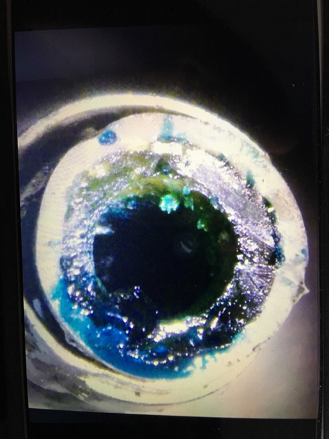

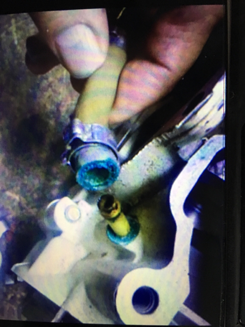

Replace them and the fuel selector. Then rebuild the carbs using OEM Gaskets needles and seats.
The Grey Tempo lines are engine killers.
This is what they do and all the green goo plugs ports and and fittings.
These are about as bad as they get, your will likely not be this bad. But they MUST be replaced no mater what as the goo plugs up everything.
