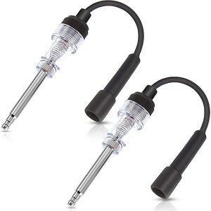

- Verified I am getting spark
- only weird thing is I only get spark to the wire I'm testing if the other is connected to the plug while installed in the motor
