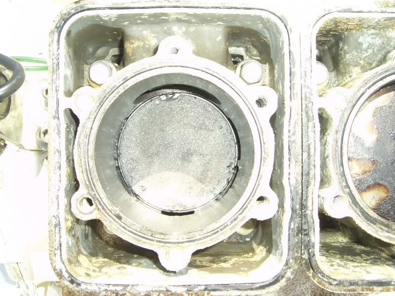

Motor went with out oil. I know 1 cylinder has no compression, but will I have to rebuild the whole motor? Your help is really appreciated.
Chances are if it ran out of oil, it got hot and cooked the engine real good...The only way to tell is tear it down.
Good luck.

ya i guess i will have to give them a call. i think the crank is out in mine. turns over, has compression, spark and fuel. just a little sluggish when cranking. like the battery is dying, even with a new battery. :(
It's not too bad, I would take plenty of pictures of how and where everything goes. I'm very forgetful though!! Good luck, guess I will be joining ya. I think mine is wasted too!!:ack:
Pulled the motor. Busted 3 head bolts taking head off. I'm planning on a rebuilt motor and going to call SBT tomorrow. Is there anyone else I should check out. I need to do this asap.
