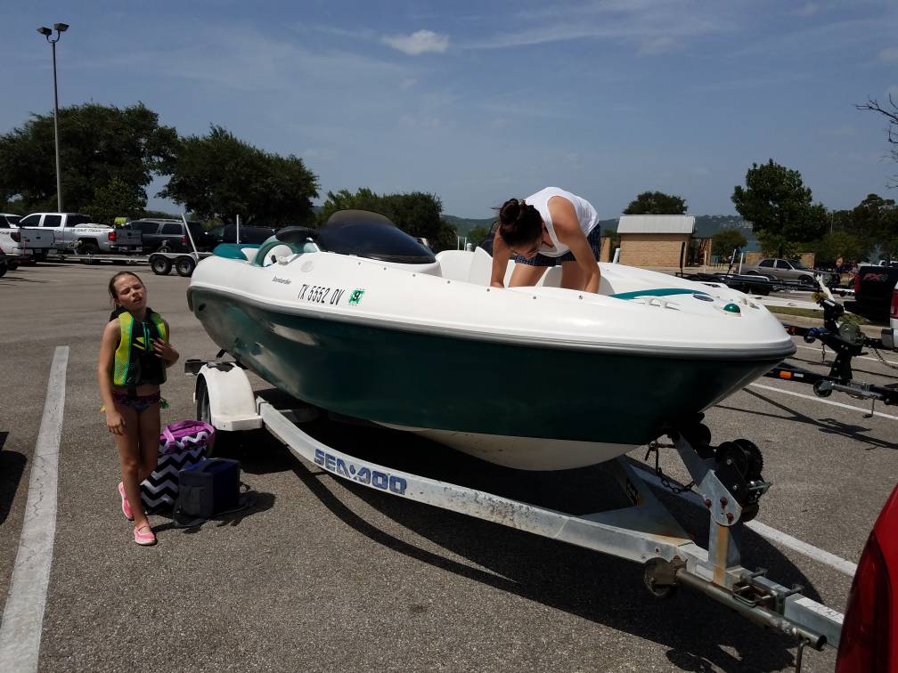

Made it to the lake and actually took it off the trailer!! Both engines started and ran up to about 4k at WOT. After a bit, one motor went up to 7k and then the other did the same. Before it went to 7k, there was a vibration coming from the port motor but went away once it reved up. After a while the starboard had a hard time and the wouldn't start. I'm thinking popoff pressure is to high and not allowing the high speed circuit to opwn up. I'm going to test compression on the starboard and hope it's good.
