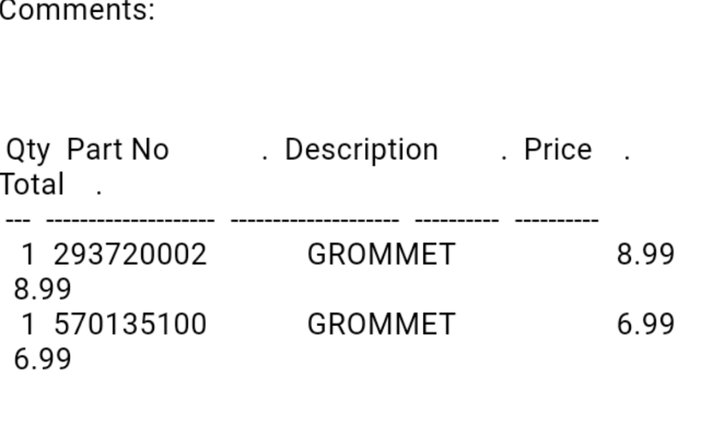

Mine was leaking from the grommets on the bottom of the oil tank. Just wipe down your hoses real good and check them in a few days they'll probably have oil on them. They are 10 bucks a piece new.
Checked those when I was cleaning out the bilge, but I'll take another look.
Thanks!
