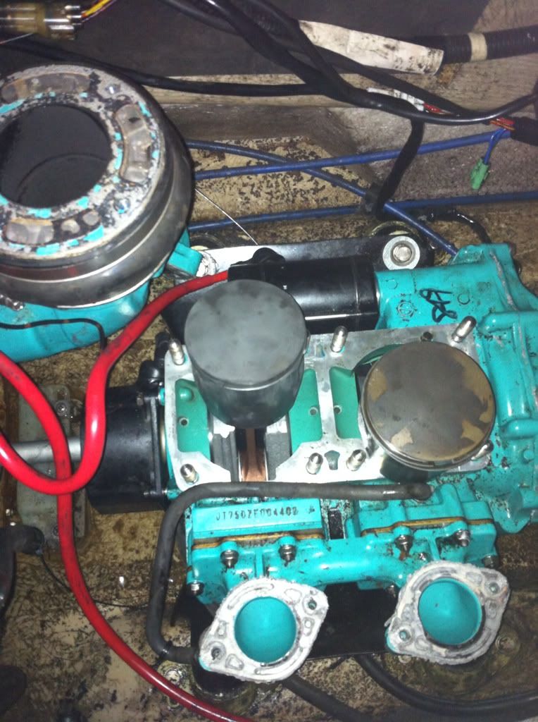

And no the top of the piston was almost as smooth as a new one. After looking over the front cyl I noticed some minute scarring on that piston as well. Nothing on the cyl wall just the piston itself
I took pictures, but can't get them to upload from my phone.
Also after pulling the engine i noticed there was gas standing in the crank case... 1/4 of an inch maybe a little more, in the bottom... Could this have something to do with it? Is there supposed to be fuel there?

Try to post this pics... that will help. You may have to do it from a PC.
http://i1053.photobucket.com/albums...15B8784-2046-0000033DF5D348A5_zpsc3413a8a.jpg
maybe one of those will work
Nope... not a piston failure. With the color on the crown... and the damage to the side.... that was a simple lean run. If you look at your front piston crown... you have a "Wash" pattern in the carbon, on the crown. The cool, fresh fuel is a solvent... and it will keep the piston crown cleaned off, where it's exposed to the bypass ports. Reading piston wash is a way of tuning a 2-stroke.
Anyway... on your rear piston... there is no sign of "Washing". That tells me that you weren't getting a good, fresh fuel charge.
Either the carb on that side wasn't happy, or you had an air leak in the case.
The other thing it could be... is lack of oil... but your front piston looks good, and you were pre-mixed... so that's not really a possibility.
One other thing comes to mind.... Since you have a reed engine... did you check the reed cage for leaks, or for high clearance? If the reeds are back flowing... it will cause a lean run, same as a case leak.
