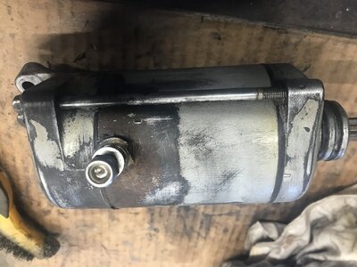

When you disassemble them just make sure the gaskets are in good condition and use a little Sealant on the joints. I spend a lot of time doing the starters. I say it is hardly worth it but when I do one I save a lot of cash. :) I took two of these apart and the insides were in great shape, brushes were almost new. All of them need a thorough clean up and corrosion removal outside and some paint. The starter should match the quality of the engine and I like doing jobs "once." :D Good Luck.
