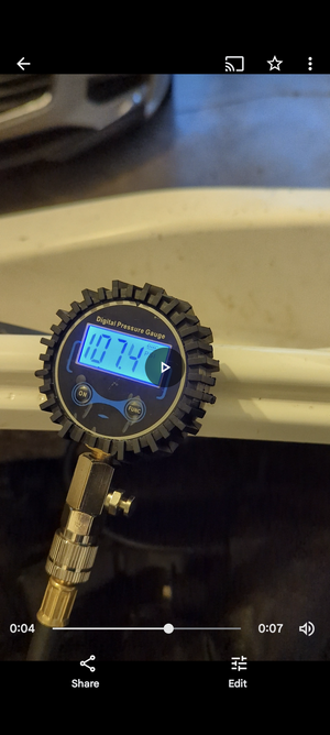

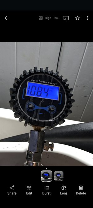

I have a 2003 Seadoo GTX-DI (Rotax 951) that I thought only needed a fuel pump. A couple thousand dollars later and it still doesn't run. SO, I've been back tracking my work. It needed a new top end. I've included screenshots of the compression before and after. The picture of the piston is the original. My question is, I installed a WSM STD size piston. The machine only had 86 hours on it, so I couldn't imagine it had anything other than the original parts (and being my first project, I didn't have the tools to measure). IF I'm reading the piston right, the cylinder has been bored out to .045 over right? I didn't know at the time what those markings meant. And a STD size piston would be outside the tolerance? Could that be the reason it won't run?

99.6 and 116.6 are the MAG piston before and after
107.4 and 108.4 are the PTO piston before and after

If you did the top end "no way" are those the correct readings. Don't waste any money... stick with it. Borrow a good compression test gauge. Find the leak. The engine is just a pump not an all in one fix.

I’m not sure if this has already been answered but we’re the cylinders bored or only new pistons and rings? Could those readings not be correct if cylinders are egged shaped?
