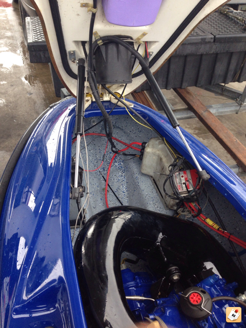

I like that, that hood is a heavy mother humper, and even worse when you're trying to lift it while on it in the water.
Ok water leaks fixed it's a crappy day here but as soon as I get a decent day it's test and tune time.

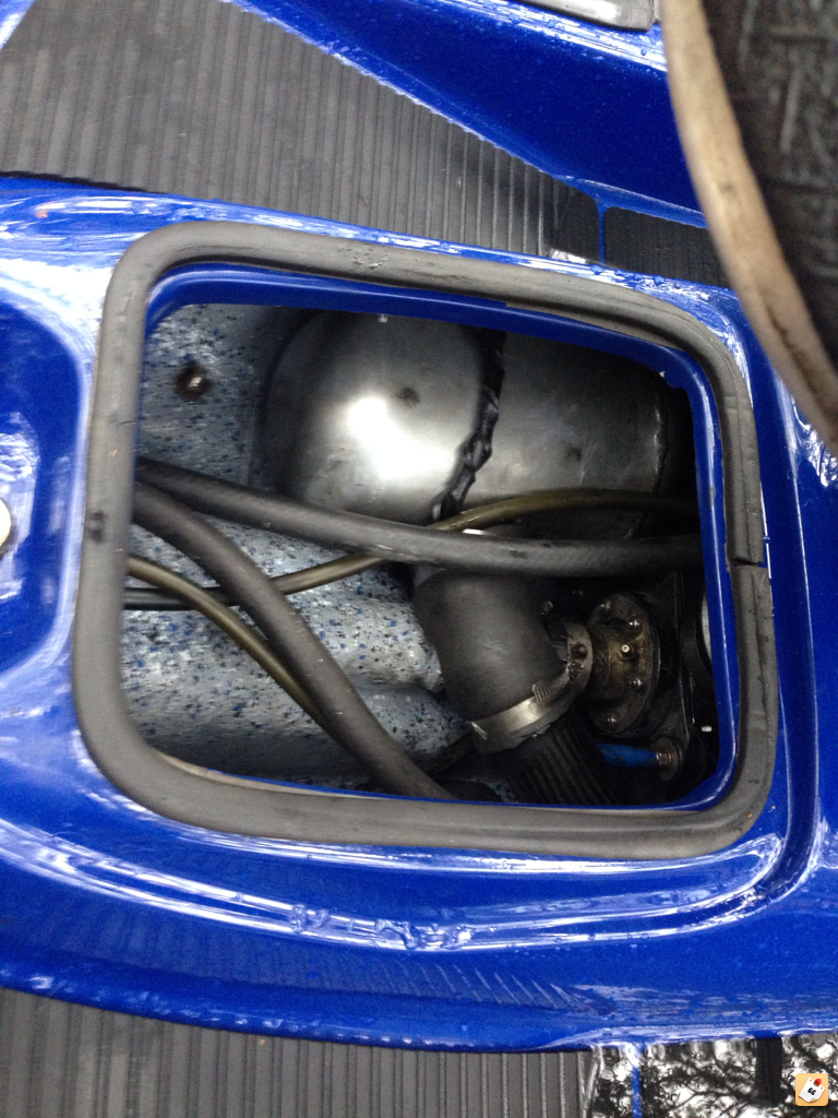

I also picked up my waterbox today it will need some modifying but shod work good

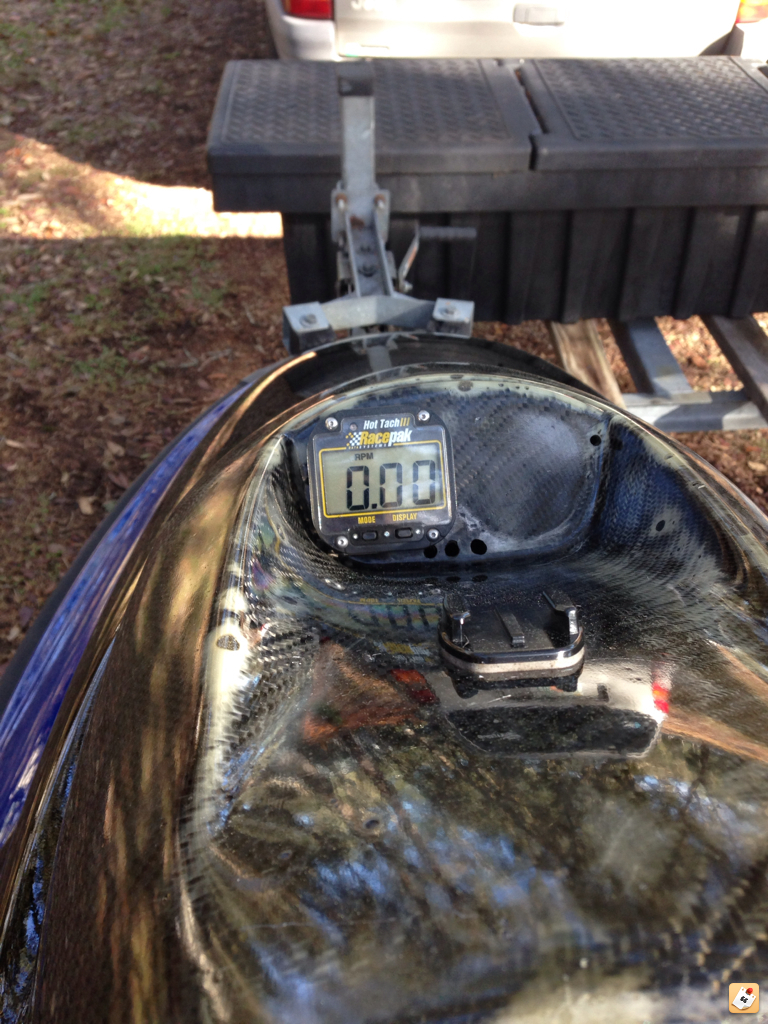

Today's test was great now I can start tuning the engine in I set the hot tach up for a max of 1030 on my egt's and a max of 7300 on the Rpm's.

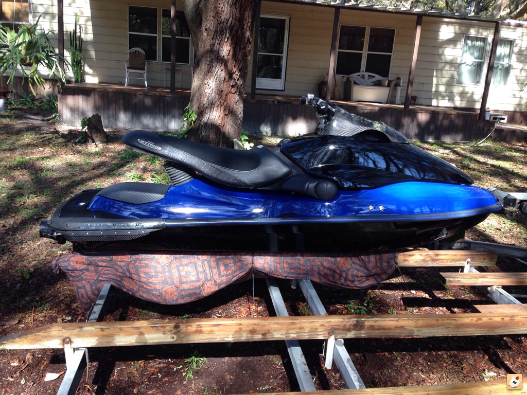

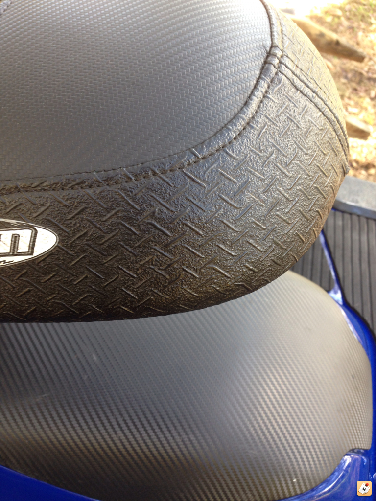

Like the carbon sponson extenders, carbon gauge pod and is that gator skin on the seat!!!!!!!!!!!!!!!!!!!!!!!!!!! If so that is F'n sweet
Your killing me with these teaser pics Dennis:toetap05:
Oh, and I love the bunk blankets, LOL.
Ya I forgot to carpet the bunks so a old blanket worked great and the seat is the jettrim diamond plate look
And the carbon sponsons are awesome what a difference in handling
