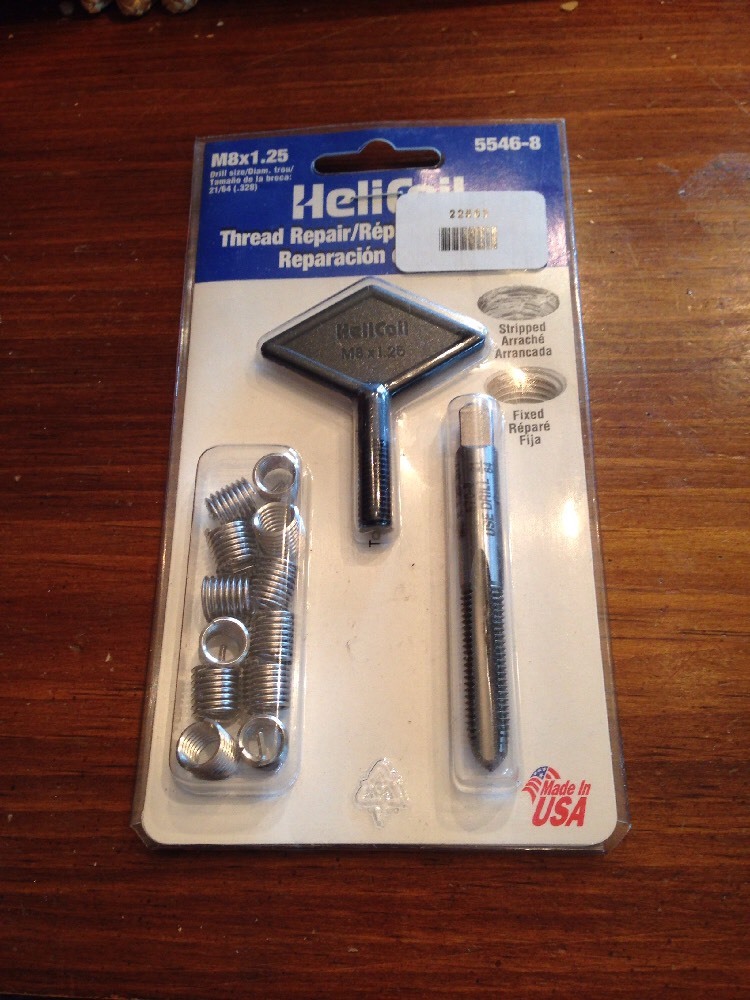

Thanks for the suggestions. I found this: canadiantire(dot)ca/en/pdp/thread-repair-kit-m8-1-25-0251213p.html at my local Canadian Tire, it looks to be basically the same as the HeliCoil kit, should it be sufficient?
Just find a used manifold, they are a dime a dozen. Also when re-installing, keep the lower pipe bolts and mid pipe bracket kinda loose until you tighten up the upper bolts. Then tighten mid pipe bracket, then the lower 2 bushings.
