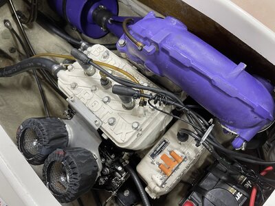

Hi! I've got a '94 XP with the 657x. Everything is stock apart from a set of ProK FAs I've put on (along with carb brace and outerwears). Even with the stock FA, I noticed it had a low end hesitation (I think?) and it remains with the ProKs too.
I've rejetted the high speed jets and lowered popoff. Current specs in both carbs are:
137.5 highs, 75 lows, and 21psi popoff.
I noticed a substantial high end improvement after this. Dropping popoff resulted in better low end response but still has a hesitation. I noticed it much more after riding a friend's 95 720 XP which had amazing low end response.
Am I expecting too much from the 657x, or should it be capable of the same low end response from the 95 XP? I have a set of 77.5 low speed jets I'd like to try since dropping popoff helped, maybe adding more fuel to the low circuit will help this hesitation?
Would appreciate any insight, thanks in advance!
