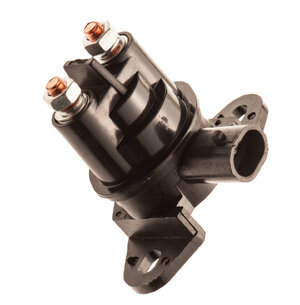

the click is the solenoid....if you are hearing it, it is probably working and you have a bad starter. bridge the two posts with pliers on the solenoid to bypass it and the starter should crank. if no crank, bad starter....if it cranks, bad solenoid.

The Starter will pull 300+ Amps across those Copper Solenoid Posts...
Which two posts? Mine just goes click, click, click, click when I press the START button. I can feel something going on in the relay, but the engine does not crank. I need to know what these two posts are that people keep referring to.
Inside your electrical box is the starter relay. Just follow the red battery cable to the box.
The two copper posts are what we are talking about.
I jumpered those and just got sparks. Nothing from the starter...

I went back out and did some more work. I disconnected both large cables from the solenoid. I then energized it via the START button. It reads open normally, and zero ohms when closed.
Also, with the starter cable disconnected, the solenoid clicks only once. It holds shut as long as the button is depressed. But, with the cables connected, it does the click, click, click thing.
That has to be an indicator of something. Why multiple clicks with the starter connected, but not when it's not? What is actually happening to cause the multiple clicks?
