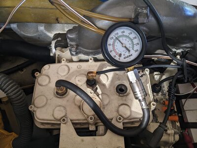

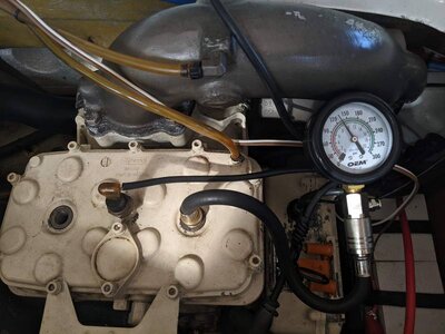

My compression seems to be OK - see pictures below. Carb has been rebuilt with genuine Mikuni parts just this summer. I actually took the carb apart again just now when I was refreshing the fuel system just to make sure there is no gunk in there. It was all clean.
Yes the compression looks to be good, the picture is on a bit of an angle but looks like it’s around 132 ish, battery is good and strong? Rotary valve cover clearance? Maybe
I'd say compression is between 130-135 in both cylinders. Battery is Duralast from 2020, I always keep it on a trickle charger. It cranks the engine just fine, no issue. Stays around 12.5 volts when not on the charger. I have not checked the rotary valve cover clearance.

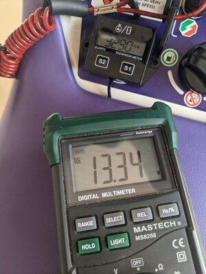

So to test the rectifier I found this recommendation:
Rev your engine to about 5500rpm. If VDC is below 13 or above 15 VDC, then High probability you hv a faulty rectifier.
Based on my yesterday's test mine is at around 13.96v no matter what the rpms are. So sounds like the rectifier is good then?

Rectifier test results:
  1. Disconnected the red wire on the rectifier.
  2. On trailer in water - similar behavior as before. Idled fine. Wouldn't go past 3000-3500 rpms. Stalled out at full throttle.
  3. Couldn't restart after stalling in water.
  4. Pulled the ski out of the water and it started. Idled fine, would start trying to stall on throttle but then would rev up.
  5. Put it back in the water, started fine and acted same as #1.
  6. Connected the red wire.
  7. Running at home on a hose the voltage was around 13.3-13.5 depending on the rpms. RPM/Voltage picture below.running volts.jpg
